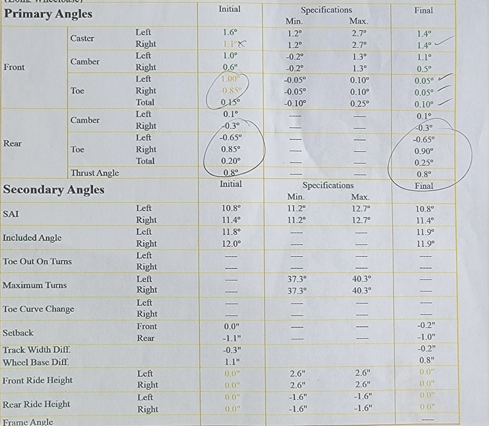

    So the lift shop had the B team on shift yesterday and absolutely dickered my alignment. They installed 5100 all around ( front set at 2inch) and a 1 inch block in the rear
    When I took it to a seperate shop to get the alignment done, they were shocked that this was a brand new truck with the alignment out this bad.
    They did their best at getting it back aligned but you can see the rear is still sitting at 0.8 for the rear.
    The truck drives like shit.
    What could have caused this? The lift shop is dumbfounded and we are working on a solution but I refuse to believe it's a warped frame like the lift shop suggested lol.
    Is there anything else alarming on these specs? I don't know much about reading these sheets.
    Thanks

    Yeah that alignment is pretty messed up. I'd start by looking at those rear 1" lift blocks. Seems like something didn't get installed correctly or those blocks are just garbage quality.
    Personal preference when it's all said and done, I'd have them shoot for zero camber and a touch more caster if possible. Everyone has opinions on that though.

    looks like the rear axle is crooked

    Common issue, the rear axle walks off and needs to be kicked into a seat.
    Poor installation

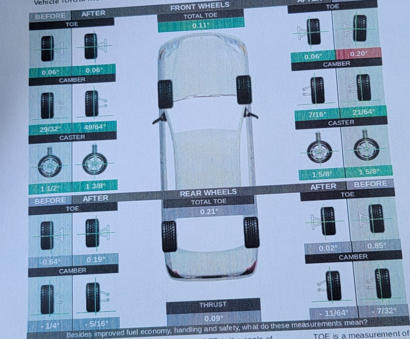

    Sitting in the specialized alignment shop they confirmed improper installation and something about pins not lining up. Hopefully I'm not rattling down the highway anymore when I'm back on the road. Thanks for the responses

    Yep, that's the issue. Should be fine after that.

    Yes that's the word they used to describe what I was feeling!
    Here are the new specs
