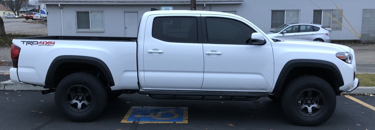

    I went with a 1.25 inch or so lift on mine and didn’t touch the rear end as I don’t tow or haul heavy with this truck. If I ever load my Honda 400 sportrax in the rear I’ll take a pic of how much it squats. About 400ish pounds.

    That looks really good what size tires are you running?
    I want to go with the TRD Beadlock rims in gray. With 265/75/16R Firestone MT/2

    Thanks. Tires are 265 75 16 falken wildpeaks

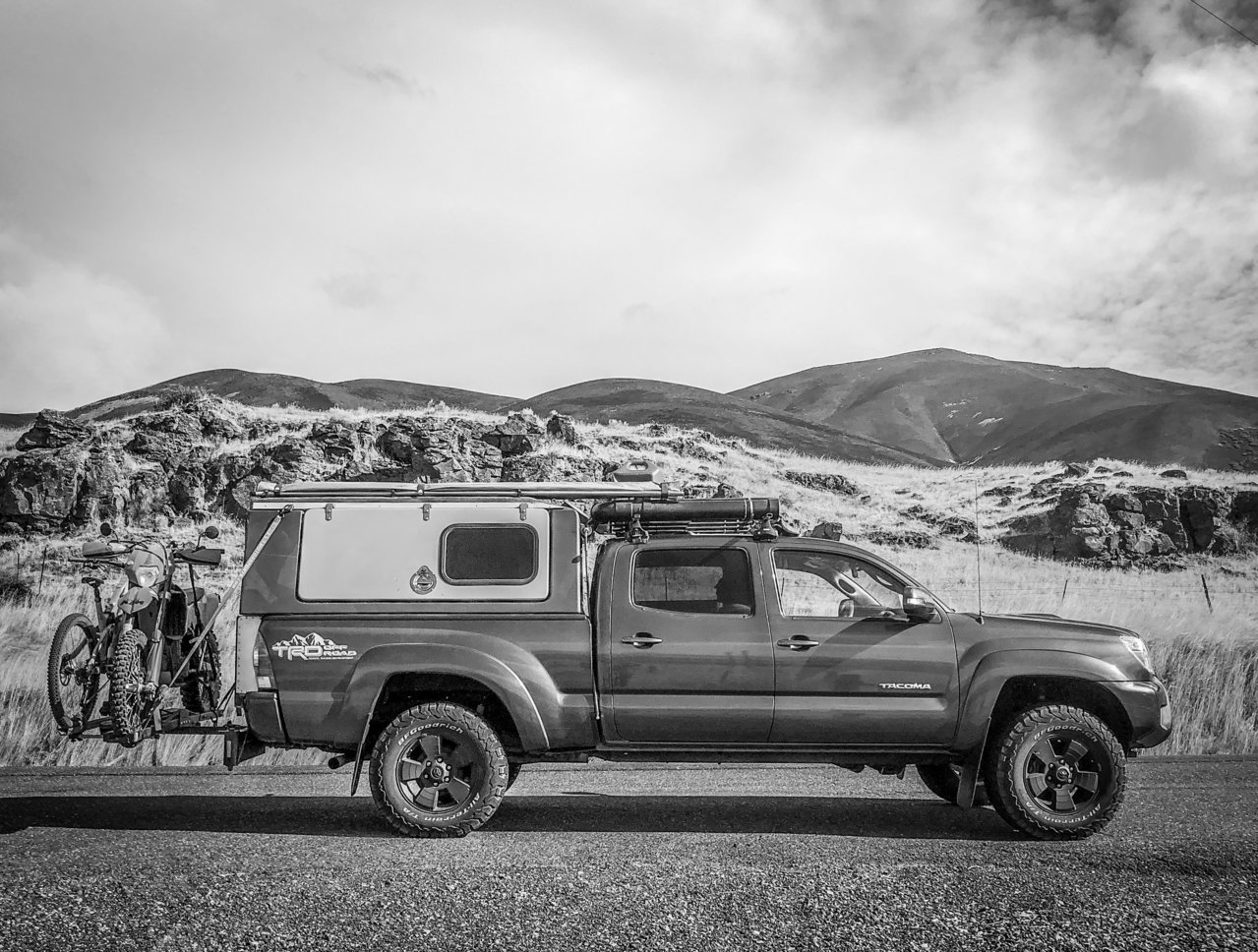

    I looked last night and Flickr was being janky. I'll look again, but don't recall taking any good side shots with it fully loaded with gear. I don't use the bags to get any kind of lift, just get it back to normal ride height.

    Best shot I could find, but not a great angle. That's with about 500-600 pounds of gear (tent, rack, camping supplies), bags at 15 psi. I will probably up it to 18 or so next trip, as I did seem to bottom out on one drainage crossing, but otherwise seemed pretty level. I use the 1 psi per 40 pounds rule, but minimum is 5 psi so might want to go 5 psi over. I have a fat tire bike pump I use that has a good gauge for lower pressures.
    [​IMG]DSCN0498 by MrTenBeers, on Flickr
