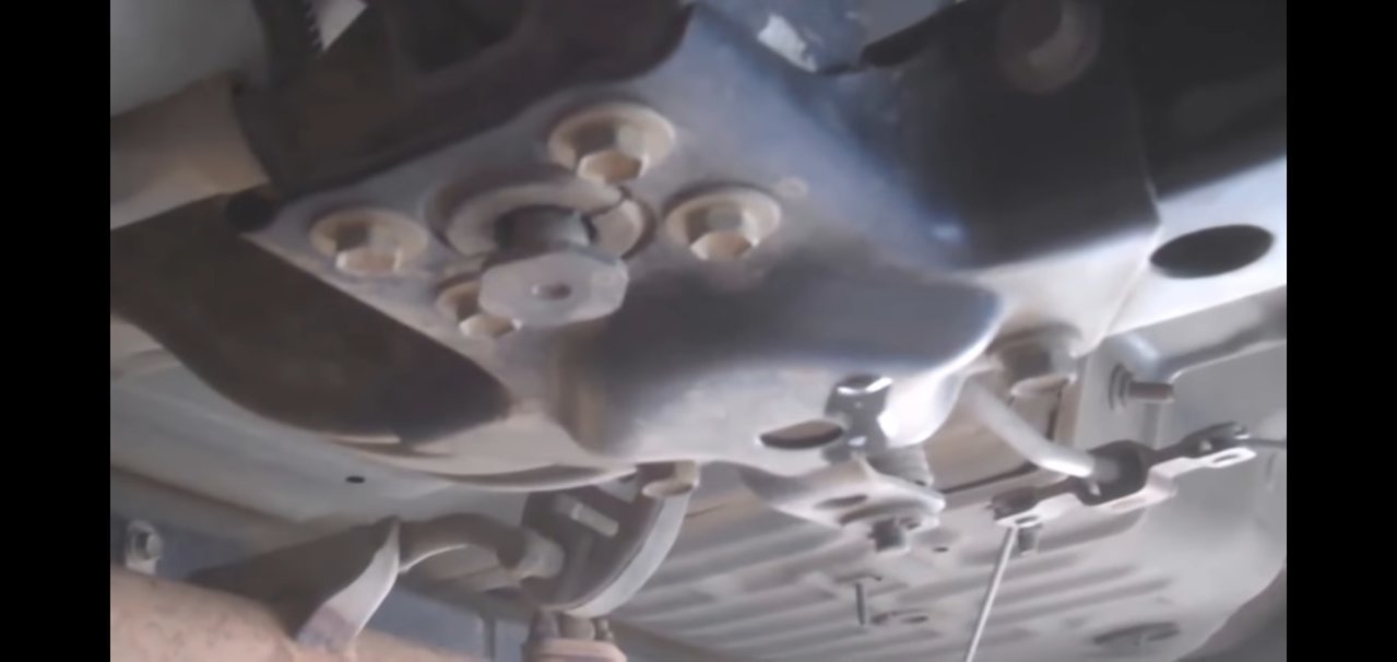

    So, I'm in the middle of a clutch replacement, and in my haste, I accidentally threw out the rear trans mount bracket. I thought,"No biggie, I'll just order another one from Toyota." Turns out they are no longer available. Anywhere in the US. Shit.
    It's for a 2.4L, 2WD manual with the W59 trans.
    Does anyone have one that they would be willing to sell?

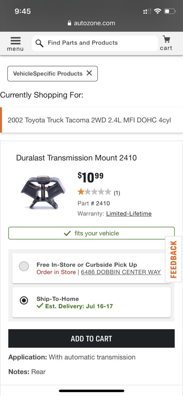

    Is this it? Looks like AutoZone. An have one in a few days.

    That's the trans mount, not the bracket it attaches to. I have a new mount, but now I need the bracket. In the pic above, it's the part with 4 bolts and the ears that wrap around the crossbar for the frame.

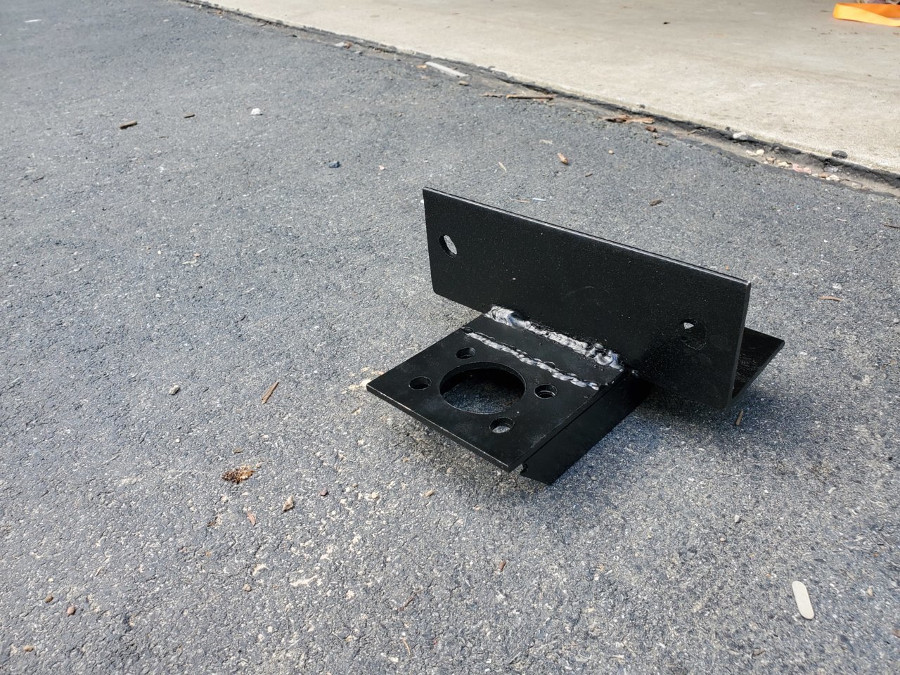

    Thank you so much for the offer, but my father in law and I came up with something. I'll take a pic to share the abomination that were making,but it should be more than strong enough to hold up the trans when we're done.

    Yeah, I was going to suggest fabricating something.
    I'm sure you could get a pic or two of a factory one from another member and copy it as best you can.
    Most brackets are pretty simple to fabricate. They're just bent pieces of metal with holes in them. A couple of pieces of L bracket and some C clamps does wonders at bending thinner material. For the thick stiff: whiskey bends (you need a welder for that).

    Here is a pic of the bracket we made. I bolted it up last night, drove the truck around, and it's holding just fine. The 3/16" steel is more than enough.

    That's no abomination, that's a job well done!
