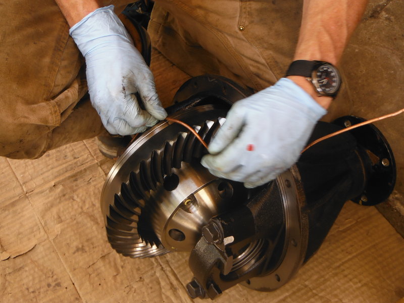

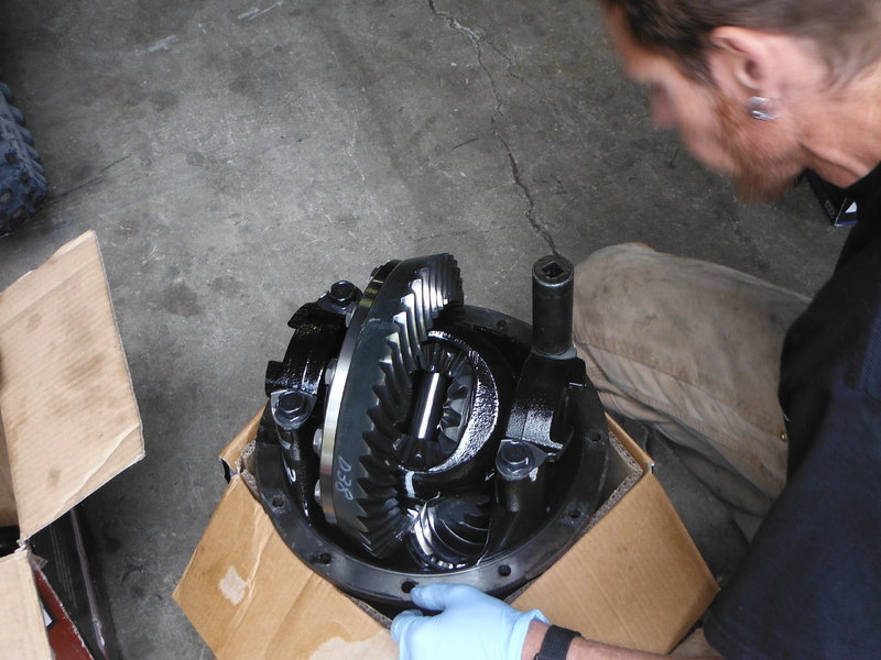

    According to Toyota's website the track of the Tundra is 67.9" wide and the Tacoma is about 63". I could always measure WMS-WMS on my Tundra's rear axle if you're interested. The 10.5" axle that Toyota puts behind the 5.7L is massive and even stronger with an ARB installed in it.
    Stock Carrier:
    ARB RD-146:
