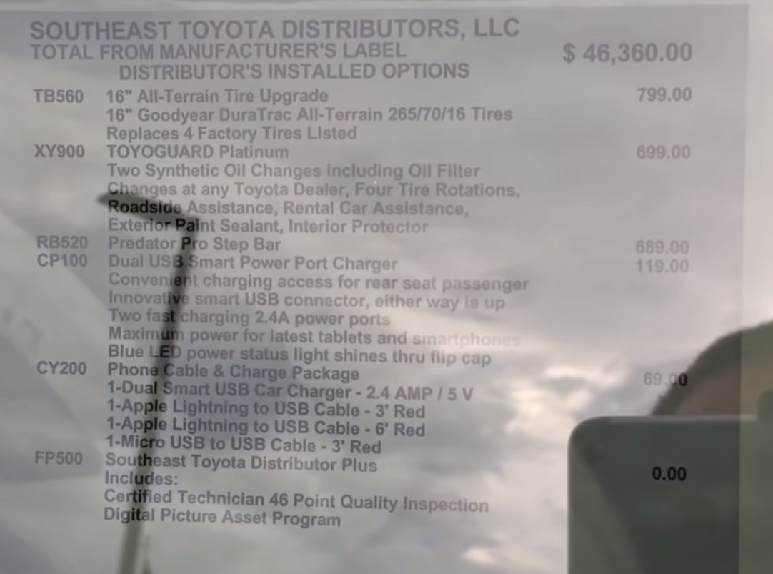

    I was watching this YouTube video (@ about 40 seconds in) on a new 2019 Voodoo Blue Tacoma TRD Pro and as the guy had the camera on the dealer sticker/sheet on the window I noticed it had dual rear USB ports (both 2.4A) listed as an option with the code "CP100". Is that an official Toyota accessory that can be added? I have a truck coming in a couple weeks and probably will have them add that in if so! Would be nice to power the kids' tablets on trips and such.
    Attaching screenshot for those that don't want to go to the video...

    It’s a factory option on the 2019’s.

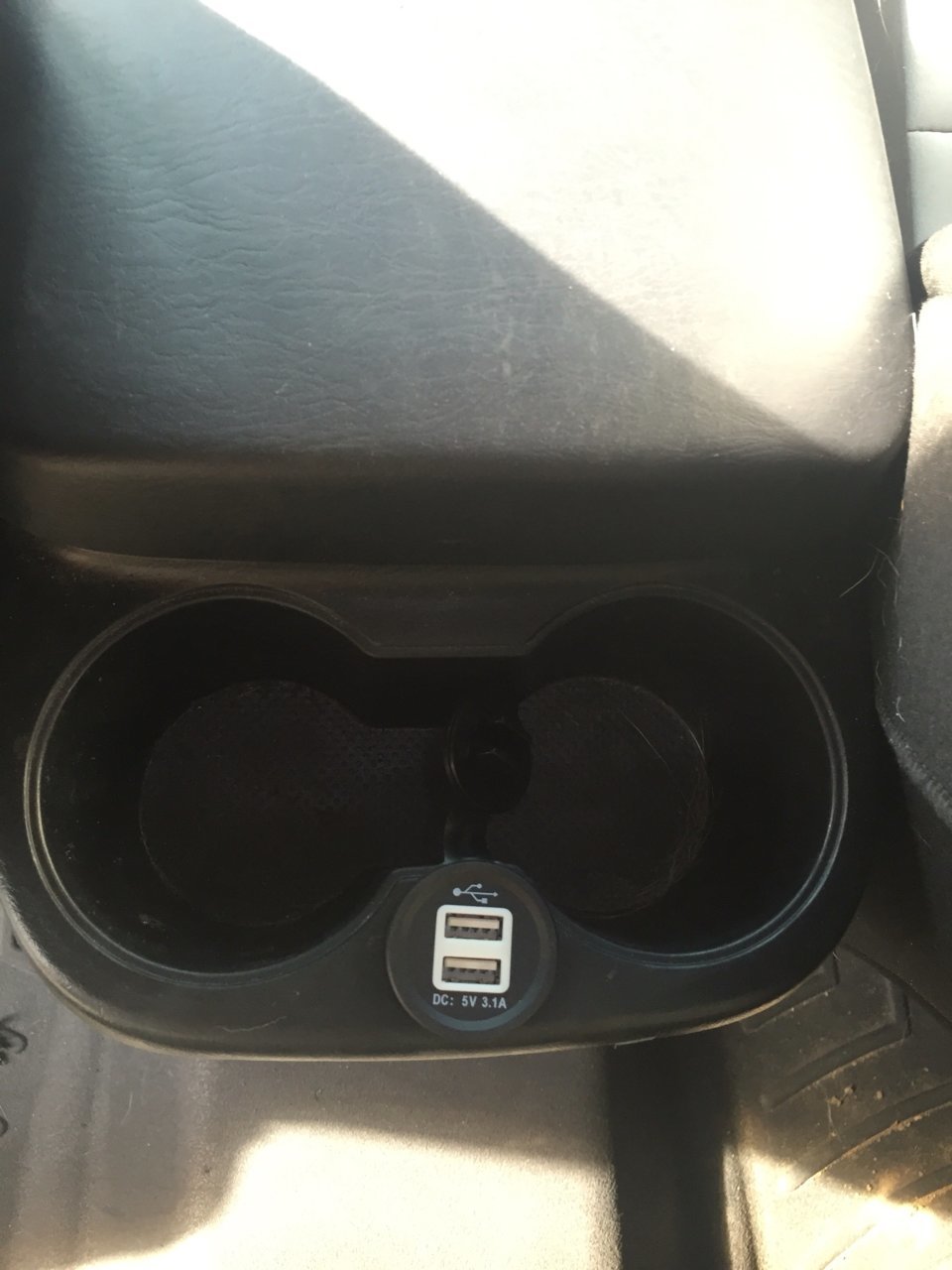

    Here is the instruction sheet for the install if you want to do your own.

    View installed. Not hard to do at all, and the parts are all available from Amazon.

    I wonder if this is new/different though. It says "Innovative smart USB connector, either way is up", which doesn't seem to be what you have pictured as they look like regular USB ports. Or are yours like that (non-directional) and you just can't see it? Also it says both ports are 2.4A rather than one being 1A and one being 2.4A.

    The actual USB port I used is not the same one listed in the spec sheet. It’s one I had already. I believe you can order the newer ports if that’s what you want. I wasn’t worried about that so I used one that I had left over from a jeep project.

    Sounds like this replaces the port installed “Connectivity Package” which added the rear dual USB and got you a baggie with two cables (lightning & micro USB) and a dual USB cigarette lighter adapter.
    This is a good thing, as the old one couldn’t do past 1.2A

    Straightforward mod, run from the console port.

    Did you have to remove the whole console to do this?
