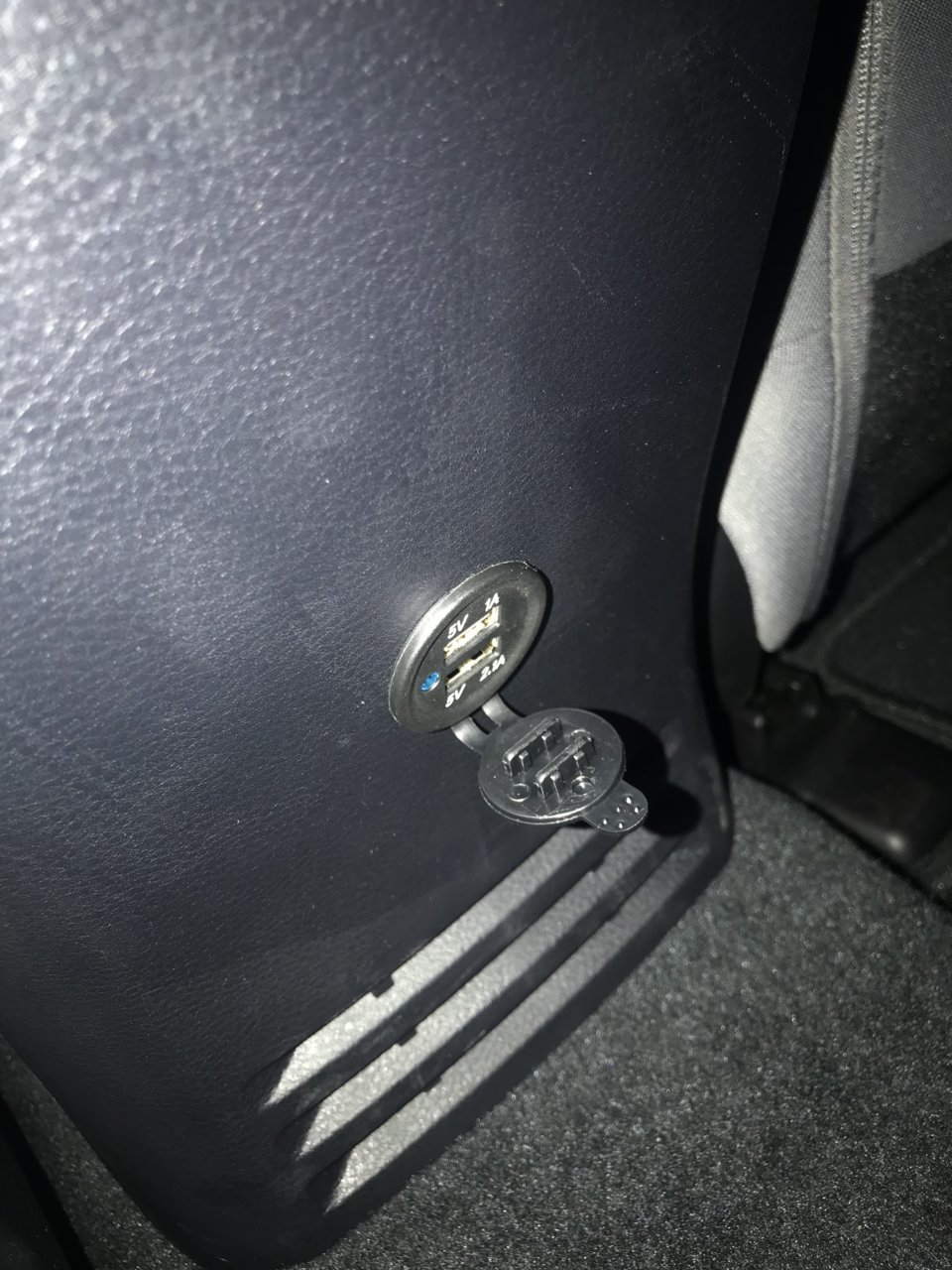

    That's how I did mine. I wired it to be always hot.
