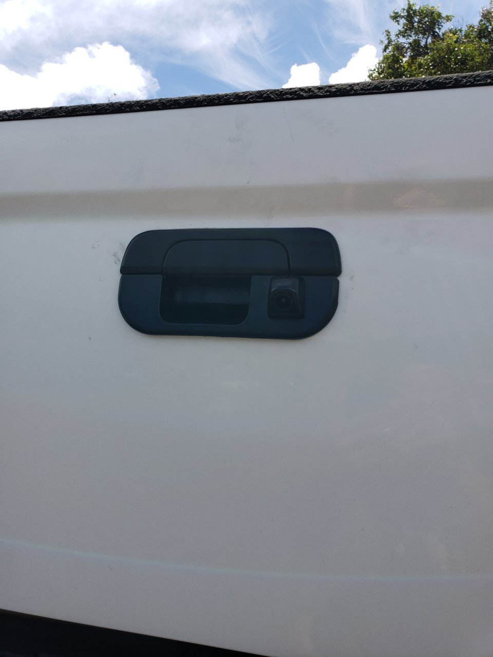

    I just did this mod to my new 1st gen. I purchased a pop a lock and modified it by removing the lock and mounting a camera to replace it (2nd gen camera look) my cams connected to an aftermarket deck though. I'll try and take pics later

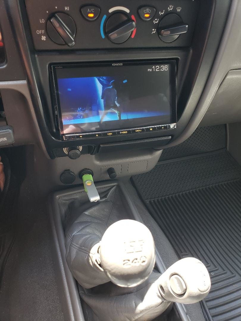

    20190301_123231 (1).jpg thumbnail (3).jpg thumbnail (4).jpg I had my friend at his stereo shop do the install on a deck I won at a tournament along with the camera. Could've use the license plate cam but wanted a closer look at the angle towards the bumper while reversing. I don't plan on having a camper or cover on this truck so deleting the lock isn't a biggie to me. It's not perfect but I'm happy with the results. I hope this helps

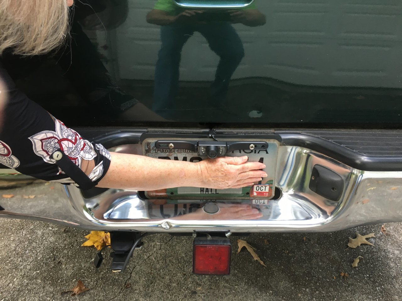

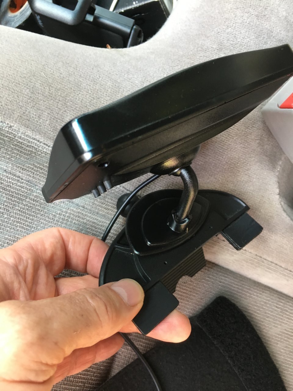

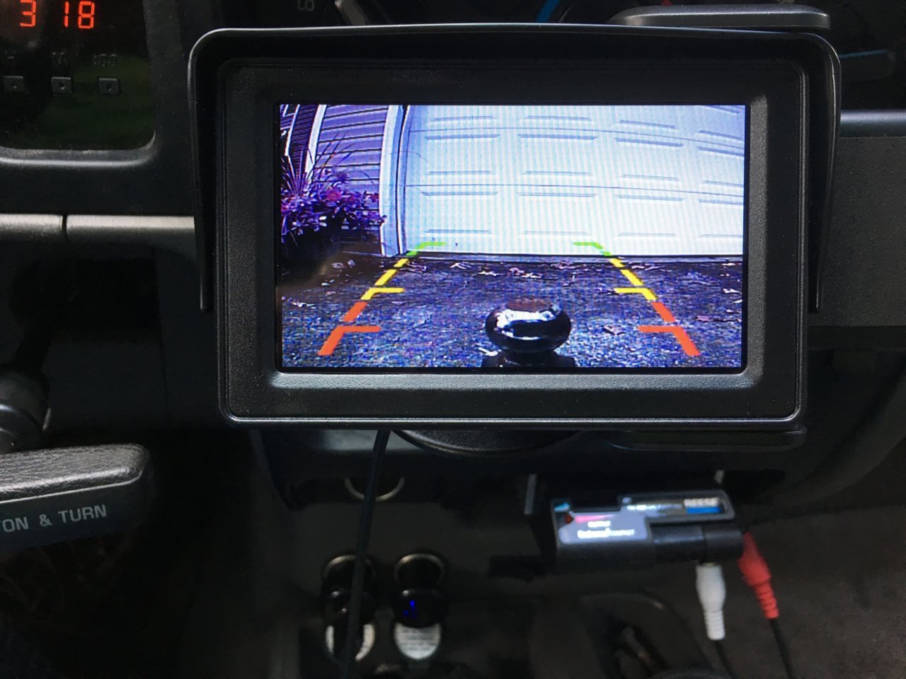

    D6C4A251-E5AD-43AE-8F68-F026D358A297.jpg EC84E6F6-E162-429F-A329-CAD871BA50B5.jpg 1D9F434E-F868-43EC-92E4-498DC11BF214.jpg
    I used the license plate screws, mounted the screen to a CD slot mount.
    Amazon about $29 for he camera/screen/wiring kit, $12 for the CD slot mount. I mainly did mine for backing up to a trailer.
