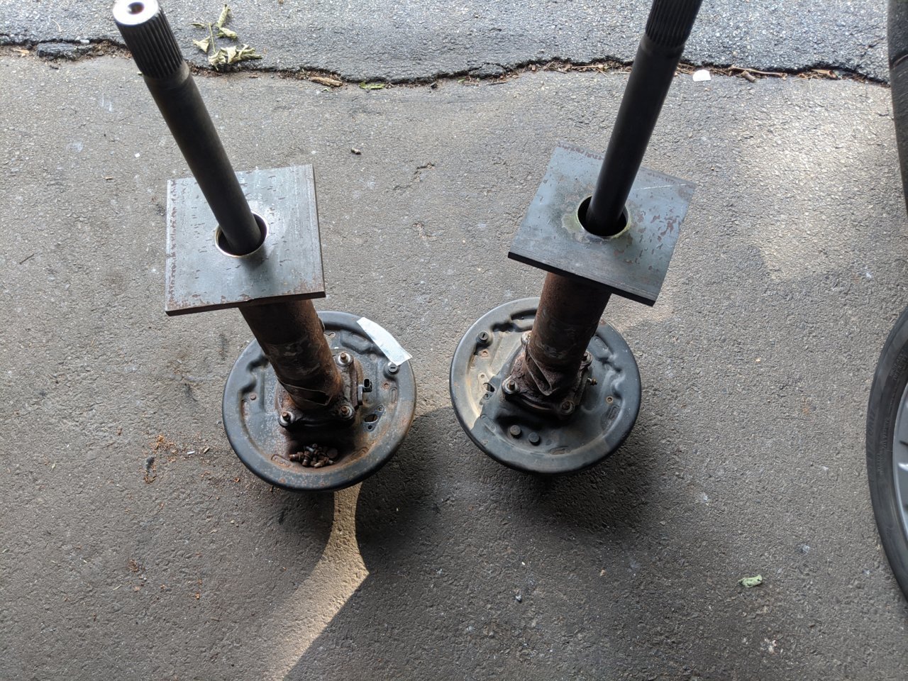

  7. Jul 19, 2020 at 10:18 AM
    Larzzzz
    Larzzzz Grande' Ricardo
    Aug 23, 2009
    #21609
    2,842
    Larry
    MA
    '06 dclb 350+ kmiles
    Aux back up lights, Bed lights, Re-located trailer plug, Good dooby, a.k.a. jumper cable mod, Heated seats, back up camera,
    It will be for me...
    2 axle tubes with 1/2" plate welded on.
    EdgemanVA and Muddinfun like this.
