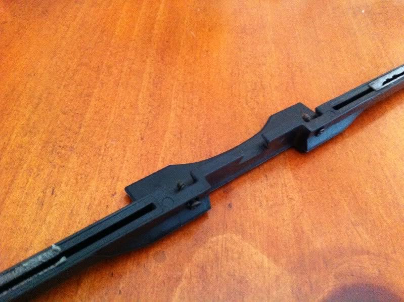

    The is part was loose:
    It is glued to the window and attaches with two screws. I could see there was some plastic in the screw threads where they pulled out.
    I was able to replace it and the screws held OK. I'm sure it won't last like this though.

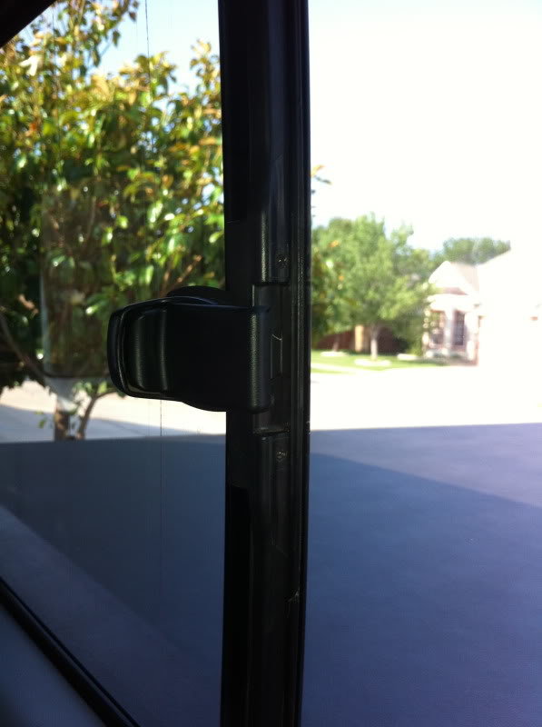

    This is the part in place - sorry about the poor light:
    I don't think there's a way to replace the part where the screws attach (which is the part that is stripped) but that would be the correct fix.
    If anyone has dealt with this before please let me know how you handled it.
    Regardless I need to get some adhesive on to stick this part back to the glass. I'm not sure what type of adhesive would work best.
