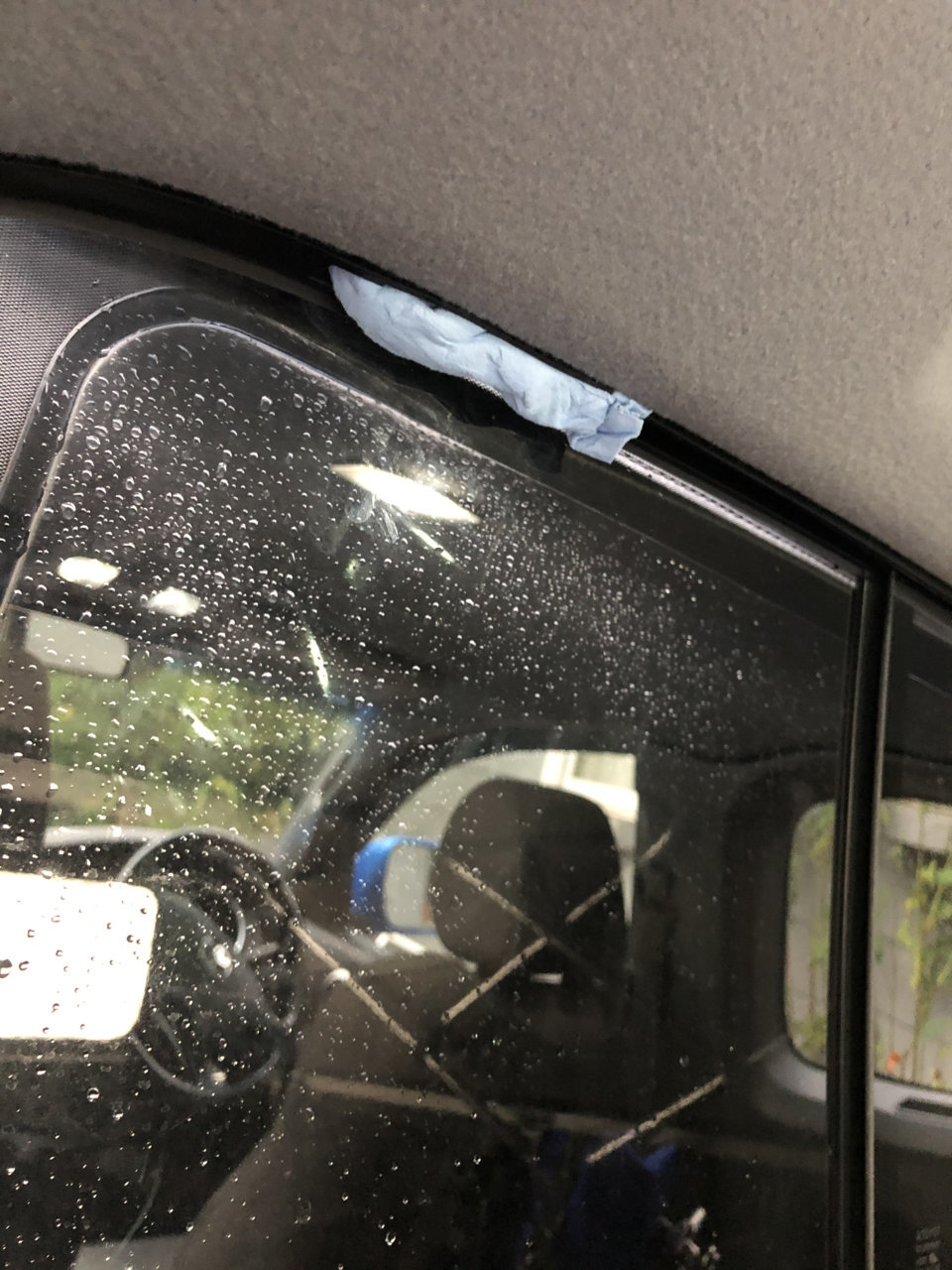

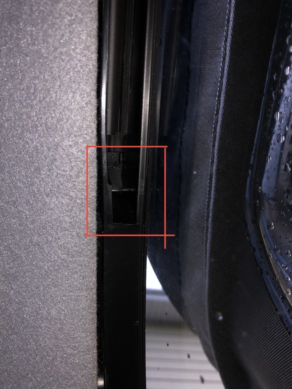

    This is where it is:
    81D23922-F128-4CE8-90B9-D18A6F88AE93.jpg CEDB6792-90B5-4E11-88CA-1127AE35F430.jpg 05E4681D-4B74-4140-93EE-5CB29102638A.jpg
    3rd brake sounds probable, but wouldn’t it be leaking from more than one area?

    Headliner looks soaked. Brakelight is my bet.

    Not necessarily, water seeks the path of least resistance.
    Like a house roof, where the drip is, is not typically where the water is coming in. So it will travel until it finds the right spot to drip.

    Looks like it was a combo. Both the gasket and the light itself. The gasket between the metal and the “housing” was bad, and the gasket between the red plastic for the light and the housing was bad.
    The gasket on the housing is not able to be purchased, without buying the whole thing. $135!
    Went with RTV sealant after drying everything up. $6 instead of $135.
