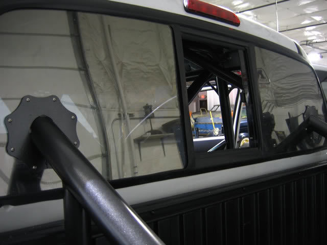

    Replaced mine with lexan panels. Easy enough -- cut, apply tint, and insert into the frame.

    I haven't had the shop do everything for me. :rolleyes: Seriously, pull the trim around the rear window and you'll see the screws that hold the window assembly in place. It's one of the easiest installs I've seen for a rear slider.
    When I replaced the one on my father's old Mazda B2000 years ago that was actually a press-fit gasket. A bit trickier but still easy. These things are not designed to be difficult.

    that looks pretty cool. you just tore out all the glass and slid these things in? is the sliding part still glass?

    Yep. The idea was the keep as many of the conveniences that came with the truck as possible, and the rear slider was high on the list. :)
