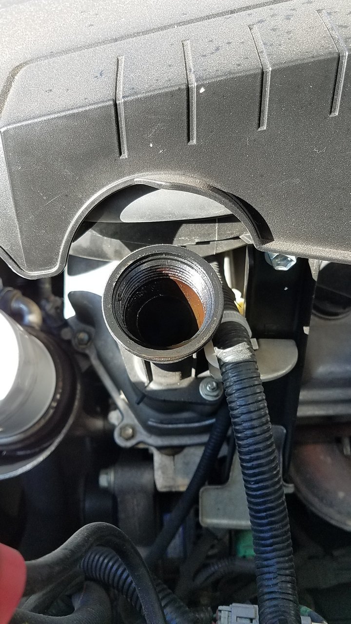

    Even if the oil change is free.
    Discovered this 600 miles into my multi day trip
    Now my Maint required light is on. I have replaced the cap (they still had it at the shop) and scanned the computer which says there are no error codes. And yes I checked that the gas cap we firmly in place
    Any thoughts

    Yes. If you were 600 miles into a trip, how did you get the cap that they still had at the shop? Or did you buy a new one and called them about the missing cap?

    Maintenance required light doesn't have anything to do with the cap missing. It's merely a mileage counter from when the last time it was reset.

    Good question. I got it when I got back to town. Shortish trip for my son's wedding

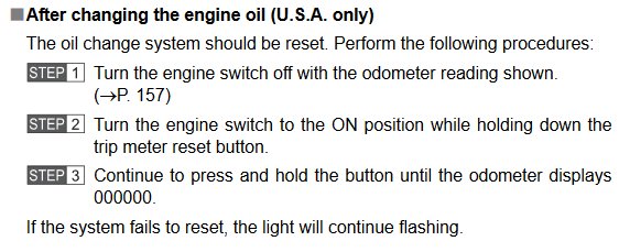

    I think you click over to trip B and hold it in until you see all zeros and it will reset it. But it's it has nothing to do with a missing cap.

    Newer second gens were Trip A I believe, older, used ODO. Not sure which year changed over. Consult with your owner's manual for proper setting.
    Go to trip A or ODO (see manual)
    Turn key to off
    While pressing in the trip reset button, turn key to ON w/o starting the truck.
    Lights will blink then release when you see zeros.

    I'll even go a step further, I'm feeling good today
    (from 2010 manual)
    Also if anything, I bet you sucked in a little extra dust/dirt into your oil. Ideally the filter should clean that out, but I think they shop might owe you a new oil change.

    It's Trip A. Press it down before you turn the key to ignition on position. Hold it until you see the 5 or 6 - - - marks disappear and complete then it will go back to odometer. Done.

    Techs dont do the oil changes.......its the same dudes that powerwash off the lot vehicles each day.

    I think I'm missing something... How did you check it was "firmly in place" but... it wasn't there 600mi ago? Why is this the dealer's fault?
