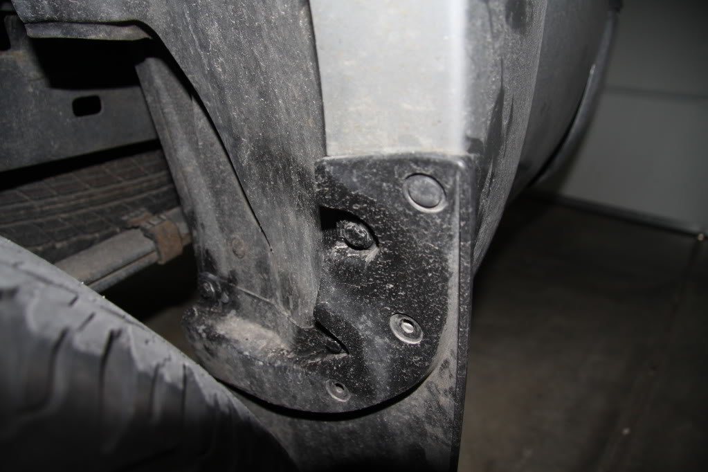

    Steps: (If mud-flap is still attached) (Start on step 5 if mud flap was already off)
    1) Use a flat head screw-driver to pry up the clips. Be careful to get between the part that comes up and the plastic piece holding the clip in the hole.
    2) Pull the clips out
    3) Unscrew the screws on the mudflaps
    4) Remove the mudflap

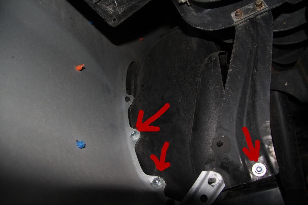

    5) Crawl under the truck where the mudflap was and find where the original screws were screwed in.

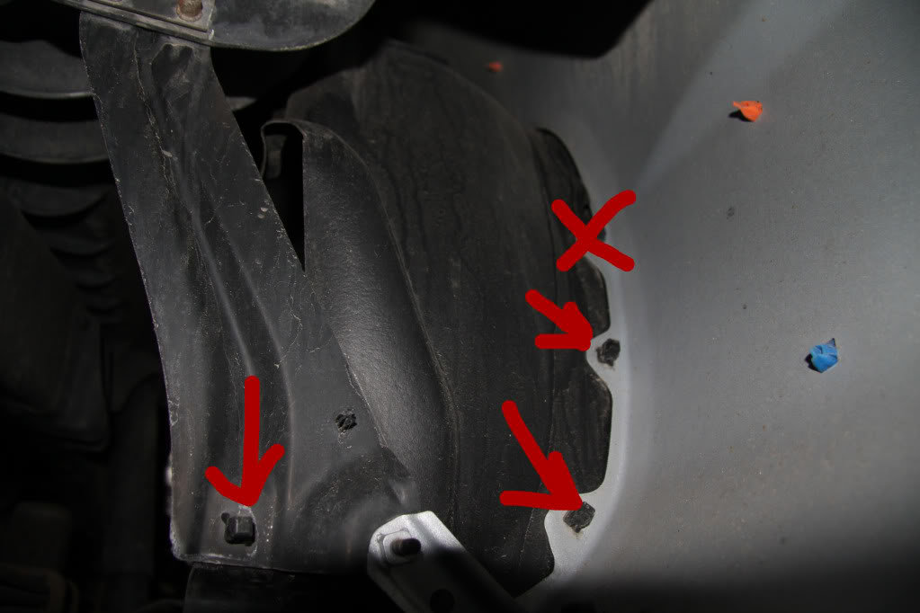

    6)There should be a small plastic piece the pokes out. On that small plastic piece there are two small parts on either side that are slightly bent out to hold the piece there. Push these parts inwards and while pushing the piece outwards (Mine were a little hard to push inwards so I used the open part of my wrench to help me have more surface area to push on).
    7) A flat head screwdriver also helps to pry it out. On the side of the wheel-well that is facing the wheel there is something similar to a washer around the hole that the screws went in. This is connected to the piece that you are trying to push inwards so using a flat head screw driver helps to pop it out.
    8) There is a piece that is behind the fender in the wheel-well that is where one of the screws went. Follow the directions above but also bend the fender out enough for you to use a flat head to pop it out.

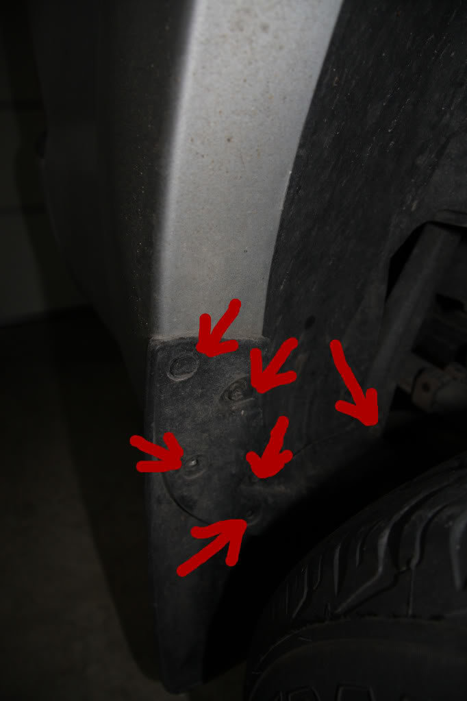

    9) Now if you look where the original screws were put in there should be just holes. You can now use the screw/bolt, washers, and nuts to replace the mudflap. I put washers on both sides and used one wrench to hold the nut in place while using the other to screw the screw/bolt in.

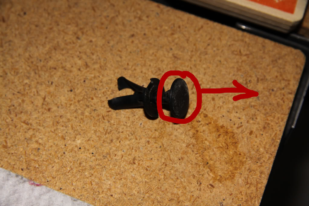

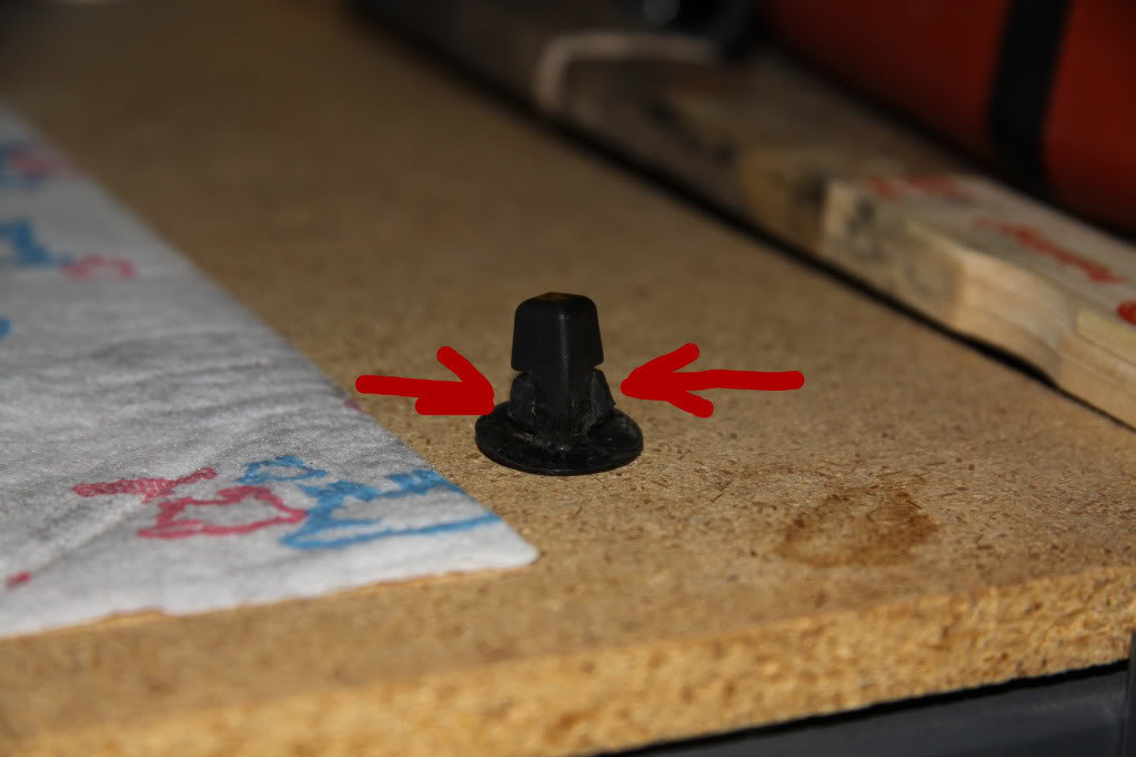

    10) Replace the clips. Make sure that the top part is pulled fully out or it won't fit through the holes.
    11) Spray the places that are shiny with plasti-dip or black matte spray paint for a low key look.
