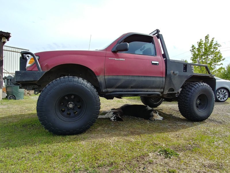

    I have 315K on my 99' 3rz...It has a slight miss so it idles a bit high and rough, but otherwise runs great 95% of time. Still gets 19MPG on 35s and 529s...I either want to rebuild the current motor and maybe add some more kick to it if possible, or buy a JDM motor. Truck is my daily/weekend warrior. What are your thoughts? Pros and cons of each?20170429_164103_HDR.jpg
