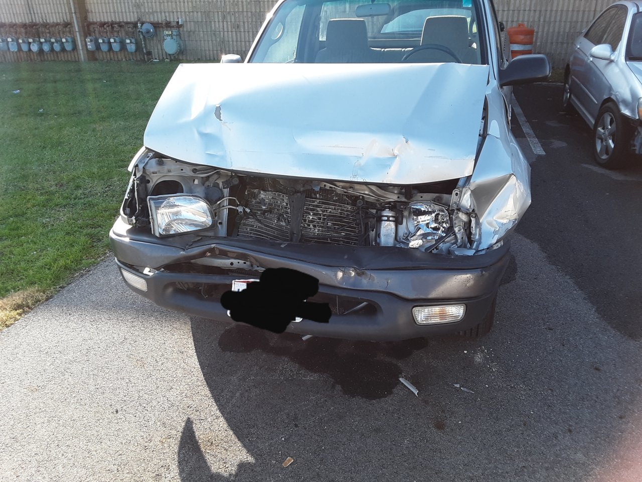

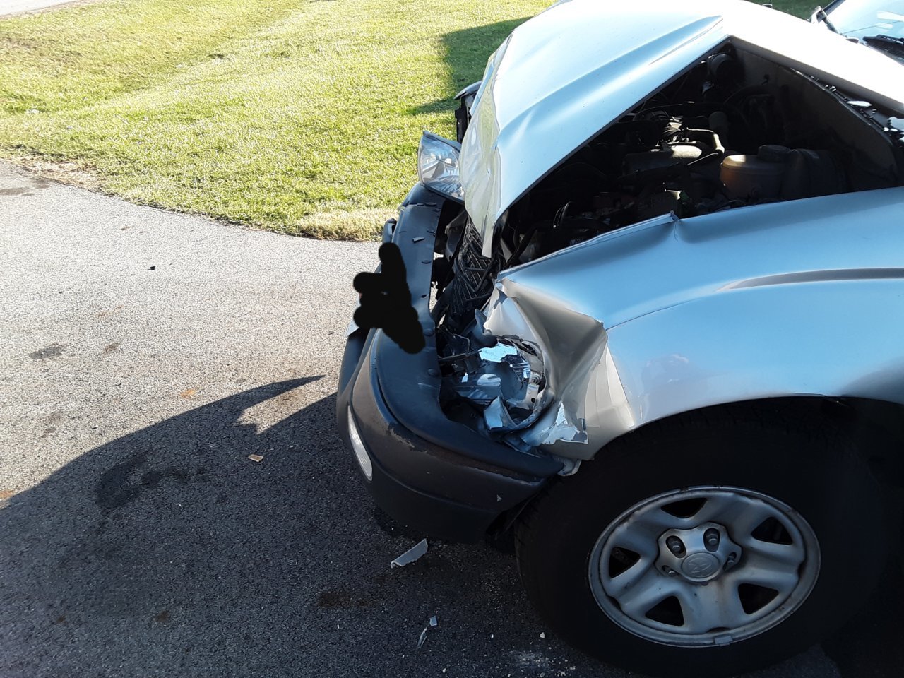

    Hello everyone! I just purchased this '01 Tacoma with a mere 107,000mi.
    Zero rust, including the frame and despite the front end damage it starts right up and idles smooth and quiet with absolutely no noises, believe it or not! Underneath is dry except the coolant leakage from the damaged radiator and the power steering still works (was concerned about this since it runs on the belt and is located in the front of the engine. The radiator is pushed into the front of the engine.
    The hit happened above the frame rail and there are no tweaks in it whatsoever.
    Preliminary examination; need front core, bumper, grill, driver fender, inner apron, radiator, hood, driver airbag/sensor, and headlights.
    I will be removing the damaged parts this week and sending it to a body shop to have it pulled.
    I will be needing these parts, so any help is appreciated. There is no damage to the passenger side including the fender, and all of the body lines are straight.
    I've only done this type of project once before about 12 years ago on a Kia, so I am definitely a novice, but I've done a twin turbo swap on a BMW and a engine swap on a '87 Chevy R10 (C10), so I'm pretty handy with tools and rather resourceful.
    I couldn't pass up on the deal because the frame looks almost new (truck was stored inside a warehouse and rarely used), super clean underneath like a brand new truck, low mileage, and the fact that the accident occurred just last week so it hasn't been sitting with the damage.

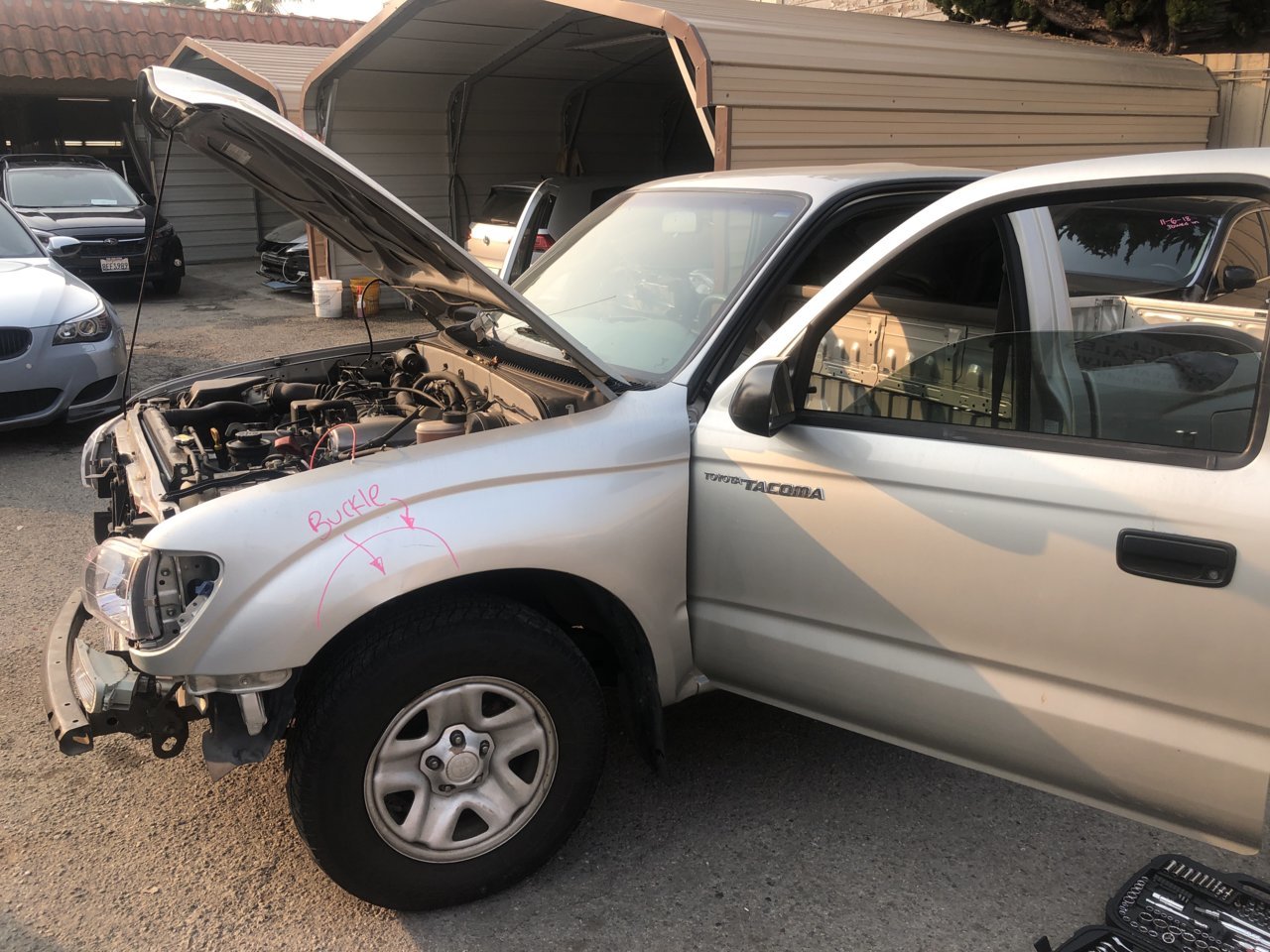

    Welcome! Had the same truck, damage not as bad but I Let insurance total it. You can find all the parts cheap and rebuild A5840338-8155-4AA8-93BF-4D238679AAAB.jpg

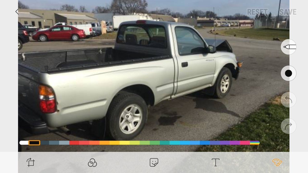

    I know I know :) had them up and decided to blank out the license plate. I gotcha!

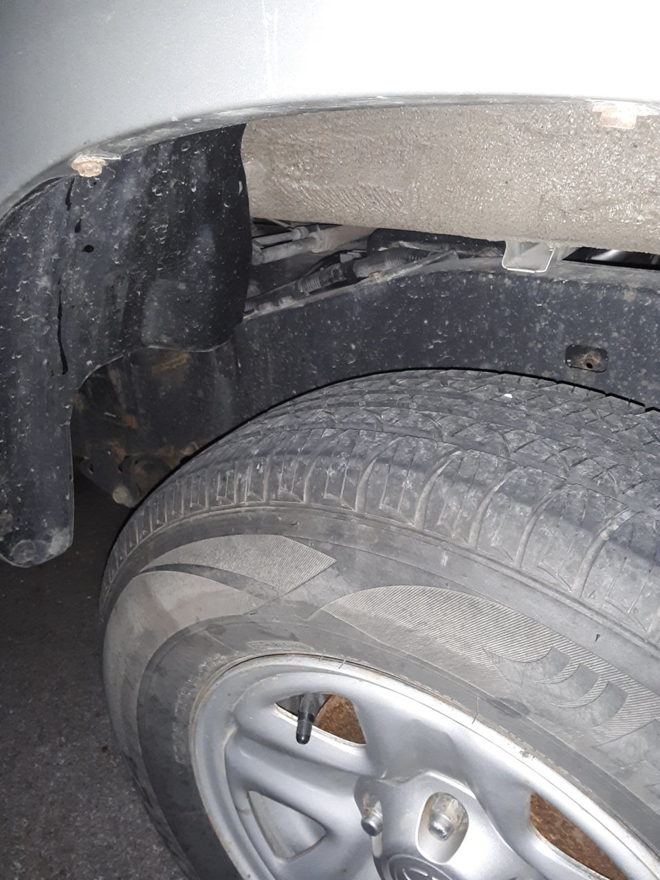

    Pic of the frame rail behind the driver rear wheel. Should I treat it with anything should I decide to keep it?20190106_220322.jpg
  17. Jan 6, 2019 at 7:31 PM
    #17
    ToyotaRacingDev
    ToyotaRacingDev SWO Tacoma Enthusiast
    Nov 27, 2018
    #273997
    341
    London, Ontario
    2008 Tacoma TRD Sport
    Yes, I’ve heard chainsaw oil sticks better than fluid film but can’t verify because I haven’t tried it. You could wipe it down with used motor oil too if you are cheap like me

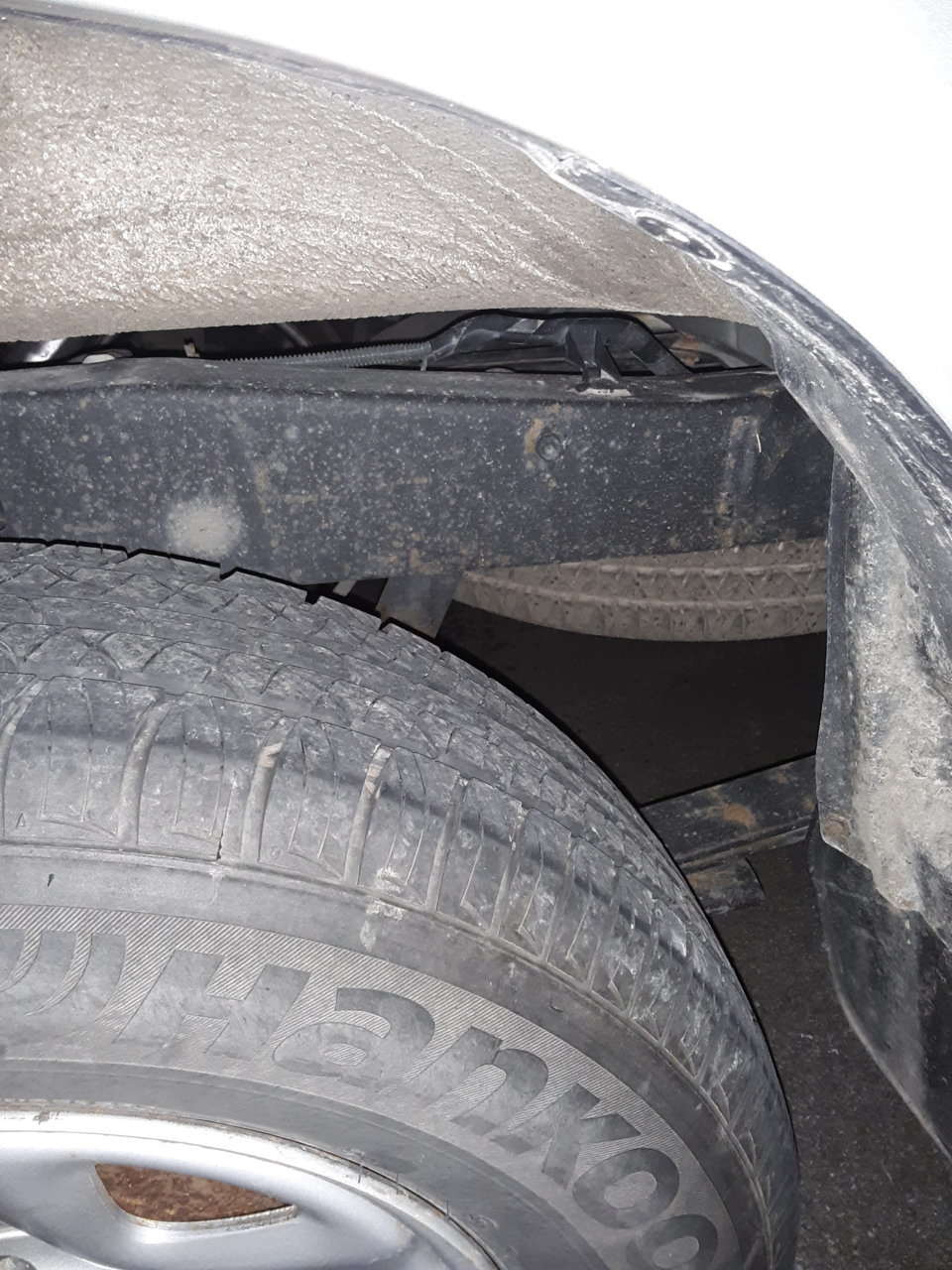

    20190106_220317.jpg amazing condition for a Midwestern truck imo
