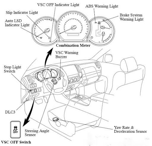

    Blake,
    You'll observe there's a switch (car on skiddie tires) on your dash that you can press-and-hold for about 5 seconds at vehicle start up to disable VSC while the vehicle is running. (First the Auto-LSD light kicks on, then after a few seconds it turns off and the "car on skiddie tires dash light goes on instead - Now VSC is off until you shut off ignition or turn it back on by pushing the button.)
    I'm convinced that user action can be replicated by building a simple circuite with one or two "time delay relay" switches (that's a term you can google on)
    Then you'd replace the existing VSC disable switch with your custom switch, without cutting or altering any factory wires. An electrical-engineer friend could help you design and solder this up, but it should be pretty simple.

    I have a 3" readylift kit w/ 285/70/17 terragrapplers on an 2010 DC SR5 4x4. I noticed that after I got the lift and tires when i am going up a turn or exiting a turn or if I hit a low point in the road I hear a high pitched whine like something trying to activate. Could this be the VSC?

    Has anyone tried recalibrating the VSC using the method above. I have a 3" lift with 33" tires. When I went to the dealer, they wanted to charge me $128 to do this!:eek:
    I asked them if there was anyway I can disable the system since it is turning on when I turn. They told me that it was a safety feature and cannot be turned off.
    Of course I left without getting it done. There are several dealers near me, so I can try others. But if the above procedure works, then I can just try it myself.

    After searching around a bit it seems this problem is not only affecting Tacomas that are lifted. It is also a common problem with lifted Tundras. If you read , the same procedure using a wire as a short can be done on the Tundra. But they go on to even adjust the angle and level of the sensor. Some people there have reported a change in their acceleration by changing the angle of the sensor so that it thinks it is nose down.
    Does anyone know the location of the sensor in the Tacoma?
    Edit: Found another set of instructions for the 5th generation 4runner. The zero point calibration technique is nearly the same as the Tacoma.

    Found this thread through another, I got this problem. I had this document here's where the Yaw Sensor is. I remember seeing couple sensors under carpet under front seat when I stripped the interior. IIRC it was not 3 bolts like the tundra. Might take a look later

    Pull the ABS 1 50 amp fuse from the underhood fusebox. ABS, VSC and traction control are disabled. Don't need nanny systems offroad. Worked on my 2012. Systems like these help make bad drivers average, but they also make good and excellent drivers average also.
