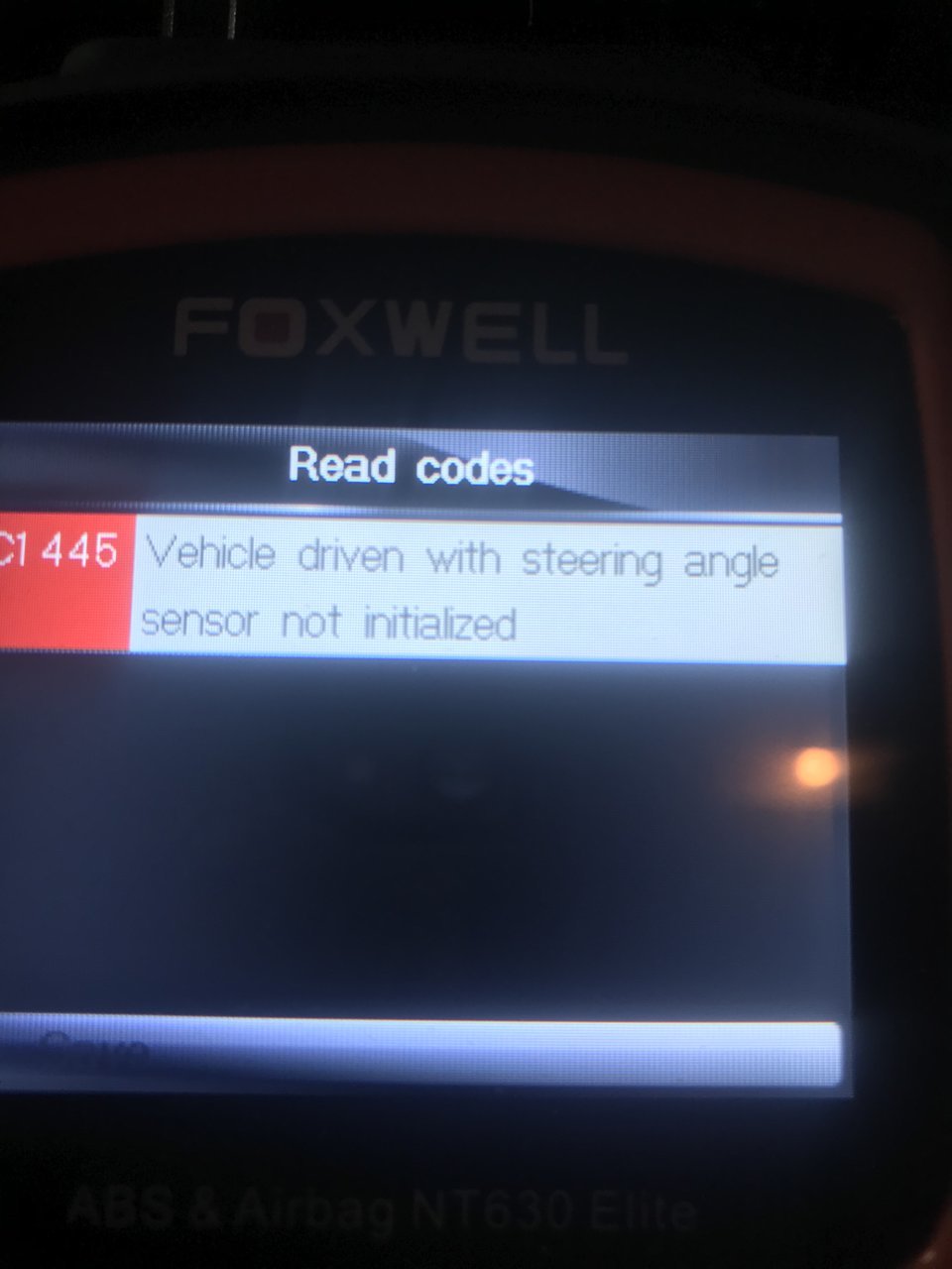

    I’m getting this on my code reader.

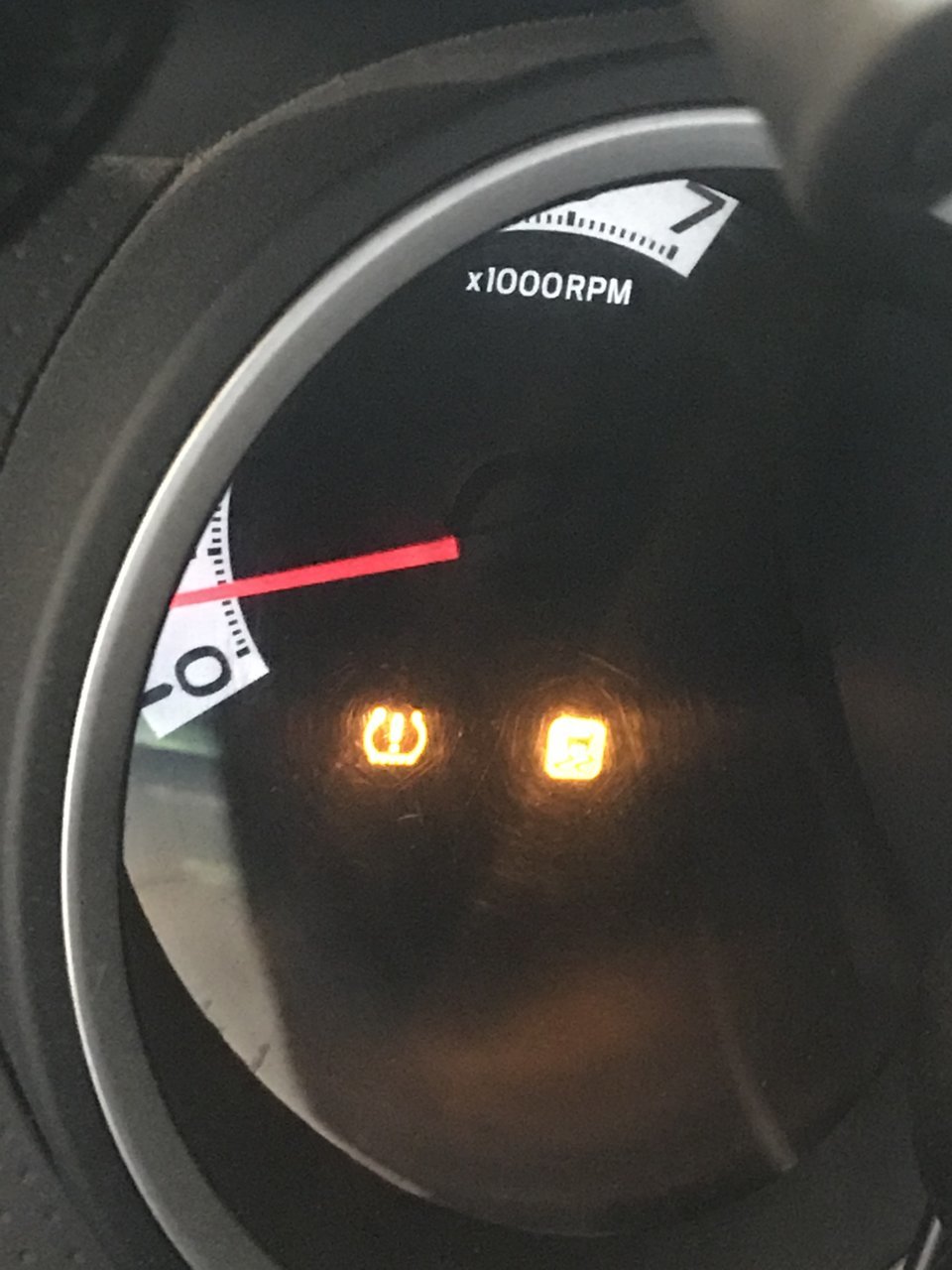

    This on the dash. Don’t mind the tire light. No TPMS
    I’ve already successfully reset the ECU via the jumper method. According to the blinks anyway.
    Is there another step to initialize the steering angle sensor? Anyone know? @Crom
    I should note that I did a 1” body lift and 37s over the winter. I had the steering shaft apart during the body lift.

    I'm having the same code on my 14 after doing the zero point several times. Did you figure it out?
