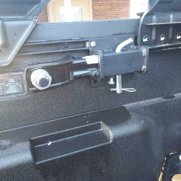

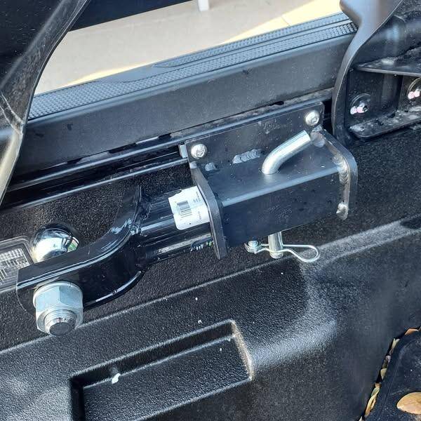

    Got my trailer hitch storage issue solved.
    I used an RV bumper mount receiver and mounted it to the bed track.
    Track inserts were found on Amazon.
    Very solid too.
    BTW. This won't work with the OEM receiver hitch. It is too short and the pin won't fit. Unless, you drill a new hole in the mount.
    These are the rail inserts.
    https://www.amazon.com/dp/B07TTHNWPN
    RV bumper hitch. There are receiver hitch mounts available, but they are cheap sheet metal. Cost just as much as the RV hitch.

    It’s almost like the truck comes with a built in place to store a hitch…

    Do people not steal receiver hitches where you live? That makes it way to easy.

    No under seat storage in the TH.

    I can always use a locking hitch pin.

    Just use a locking pin. You can get them as cheap as $10.
