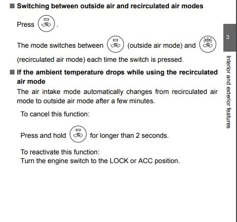

    I have a 2010 Tacoma, and this one thing drives me nuts. I will set the climate control to Recirculate, and depending on outside conditions it will stay that way indefinitely or switch itself to Fresh Air within a minute or two. I understand fresh air can help with keeping windows from getting fogged up, but I am also capable of determining when that is an issue and when it is not. If I want to smell diesel exhaust and dairy farms, I can switch to Fresh Air myself. I don't need my truck to do it for me. Does anybody know what it would take to eliminate this unwanted feature from my climate control?

    No the mods I did prevent the A/C from being forced on in defrost and prevent the recirculate and A/C from being forced on when the temp knob is on full cold.
    What the OP is talking about is a "feature" some of the earlier trucks had, mine does not.
    There's no way I know of to eliminate it although according to the owners manual it can be overridden but must be done each key cycle.
    If you just want it to stay in recirculate all the time turn it to recirculate and unplug the servo for the recirculate door.

    I have definitely had the recirc pop off on cooler mornings on the drive to work through the valleys. I have the mod done so you AC isnt auto on with defrost, and I think in doing so it makes it to where pressing and holding the recirc button to force it to stay doesnt work unfortunately. Ill have to test the next time it pops off of recirc to verify.

    Press and hold for more than two seconds. Thanks! I will give it a try tomorrow on my way to work.
