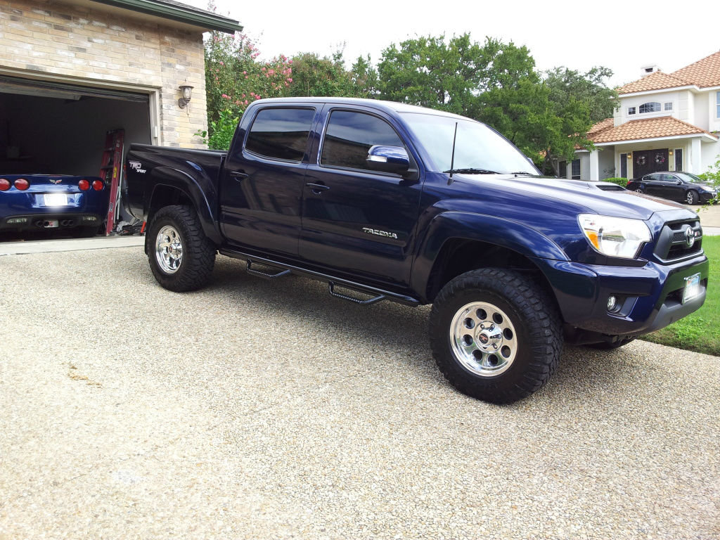

    265/75/16 S/T Maxx 16X8.5 Level 8 Trackers 5100 1.75 HID, LED interior, 3" N-Fab step bars
    http://www.discounttire.com/dtcs/fi...=2012&pc=64080&wd=16&rw=&vid=021442&rc=TWEINT
    http://www.discounttire.com/dtcs/fi...=2012&pc=64081&wd=16&rw=&vid=021442&rc=TWEINT
    See my write up on Level 8 Trackers. I have the polished, but they make them in black too.
    http://www.tacomaworld.com/forum/wheels-tires/198489-level-8-wheels-3.html#post5342010
