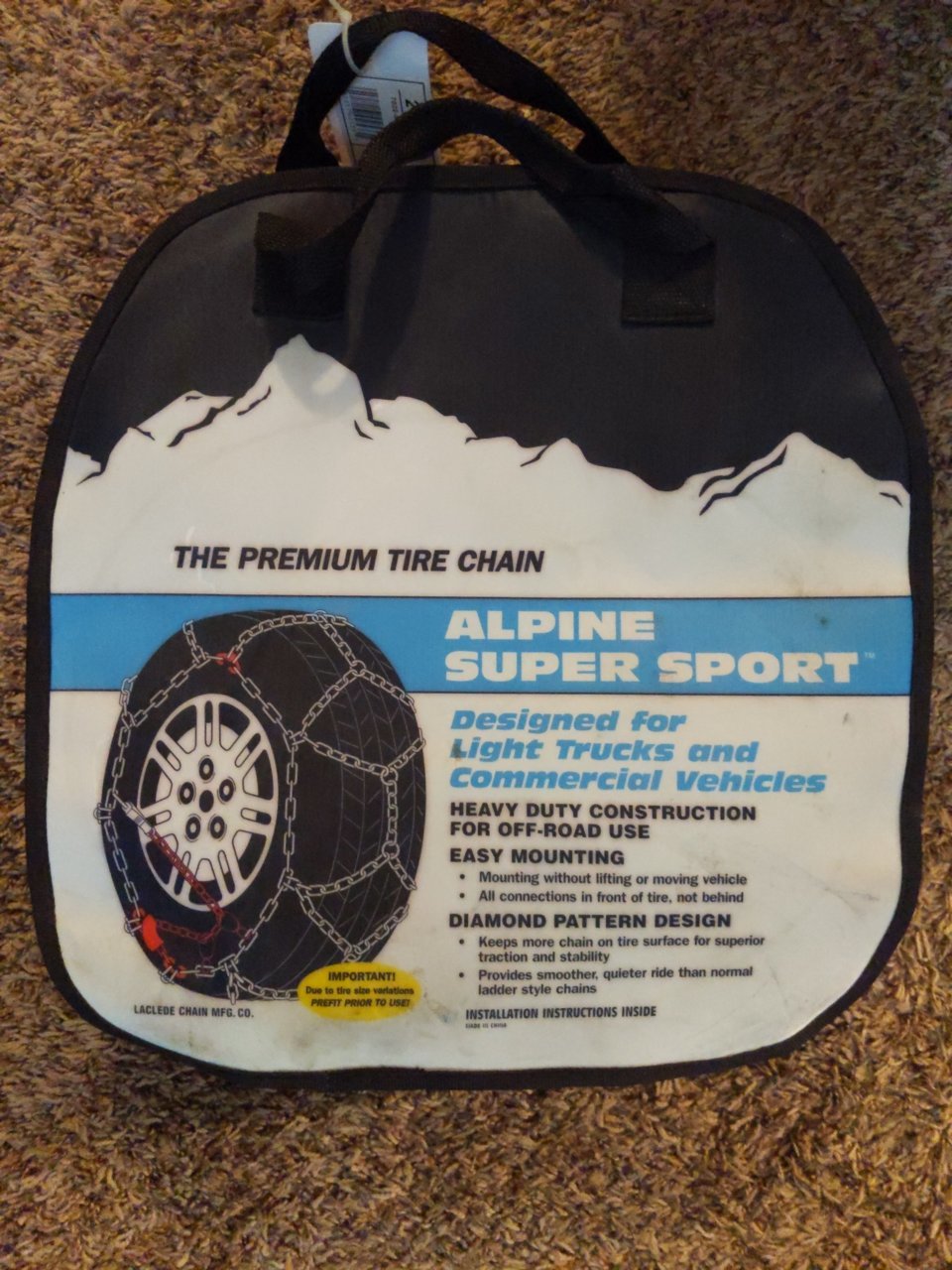

    I run the heavy duty chains from O’Rileys. I forget what exactly I’m running. I’ve never had to chain up due to the tires I’m running (General Grabber ATX) and the fact that both my trucks are 4x4’s. They’re more so if there’s a chain requirement I at least have them on me.
    Fitment is as expected with chains on bigger than stock tires. I clear everything.
