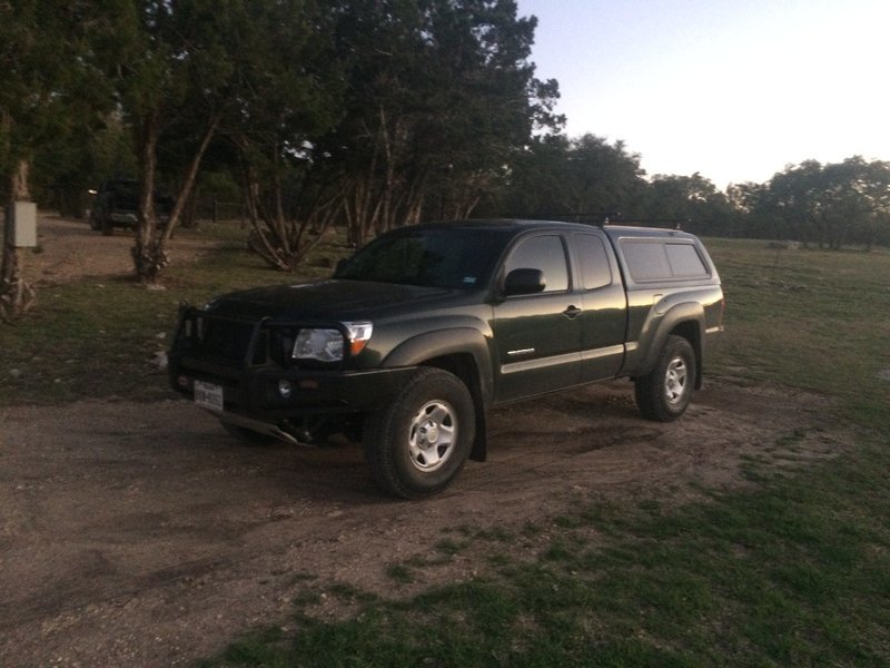

    IMG_2111.jpg Another vote for michelin ltx a/t2's.
    I have 265/75/16 on my base model, and love them so far

    Completely stock. No rubbing at all and i kept my mud flaps

    It shouldnt be a problem, thats the largest size you can run on stock suspension without having rubbing issues. My front end is actually about 1/2inch lower than stock since my bumper is making it sag. I was honestly expecting them to rub some when i got them because of the sag, but i was pleasantly surprised
