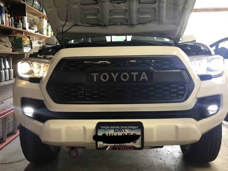

    2019 Tacoma TRD Pro Voodoo Blue
    TRD Performance Air Intake

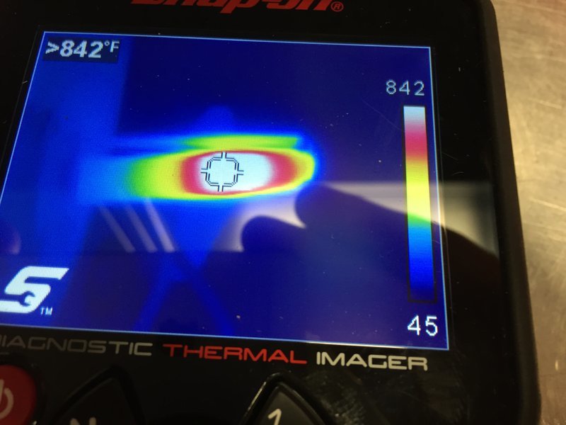

    Depends what your goals are really. Seems to me that if you want reliability you'd stick with the factory halogen h11s. If you want light output then HID is the way to go.
    Sure the leds will work with the factory wiring but no thx on the cooling fans not to mention the chance of getting true Cree grids is unlikely when you spend 35$ on Amazon.
    Halogen bulbs run on the order of 1000 degrees. TRUE HIDs run cooler on the bulb itself ( not the arc ) but you won't find a "true" hid on Amazon. The only real HIDs are made by Osram and Philips and they DO NOT make aftermarket bulbs or kits reguardless of what any website tries to sell you. Your best bet is to go with reputable companies that re-base Philips bulbs.
    LEDs are a market currently flooded with crap products and the only way you know if you got a real Cree LED is to inspect the grid with a microscope. No thx, I'll run my Morimoto HIDs or my XenonDept kit which both source Philips bulbs, Osram salt, etc.
    By the way here's a real HID bulb with a thermal camera, notice it's running about 850 degrees ON THE BULB and the rest of the assembly is cool.
    Here's also a list of most common plastics and their melting/flash points. The fact that LED assemblies get that hot is scary.
