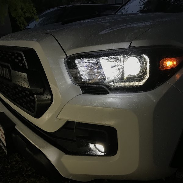

    OP these are HID's: https://www.tacomaworld.com/threads/hyluxtek-hid-kit-with-cnlight-ball-bulbs.457461/
    after watching all the different threads it seems to me this one has the cleanest installs and the fewest complaints... in fact i don't think anyone in there is unhappy last i checked. i have this kit and the install is easy, the setup is clean and waterproof and runs off a relay with no taps to the fusebox, the color temp matches the LED driving lights, and all around throw and performance is spot on. the 35w at 4300k puts out more, actually way more, than my OE HID's on my VW R32. the HID's match up with the lenses very well and the throw is great. just putting it out there.

    739
    2016 Limited
    I've read too many threads on this topic here and elsewhere and this post sums it up pretty well. Modern LEDs are GREAT, just not great in a 3rd gen projector as a proper headlight.
    I've got a set of Xenondepot 4300k Philips HIDs, if you need more light than these put out at night you're problem is not with your headlights.

    Thanks everyone I think I am going with the HIDs after reading all the feedback .

    Not a dumb question, the low beams are h11, high beams are H9. If you get an H11(B) HID kit, that will work with your lows. IMO, don't worry about highs..the high beams in conjunction with the HID lows are plenty of light when you need it. I never have to use my highs because my lows are so good.

    THIS right here! Brighter does NOT equal Better. These projector housings are designed for a capsule that emits light at a 360 pattern to create the proper beam "cutoff". With the LED options, they do NOT emit light in the way a capsule does so you will lose a lot of the focused beam pattern and just emit more of a flood light. Sure, it looks brighter but you actually have less usable light in a focused area. HID would be closer to the Halogen minus the little igniter wire that can cause a slight shadow in the beam pattern but overall emits light as a Halogen capsule does. However, as others have stated, the aftermarket HID's are low quality and cost. I have seen so many threads around vibration and fitment issues etc. I think in general for trouble-free light you stick with stock bulbs.
