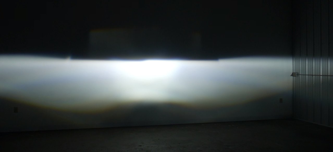

    And I'll provide what happens when installed correctly along with incorrectly. This should explain to you how you're being blinded. But ignore the proof if you'd like. :lalala:
    Installed correctly:

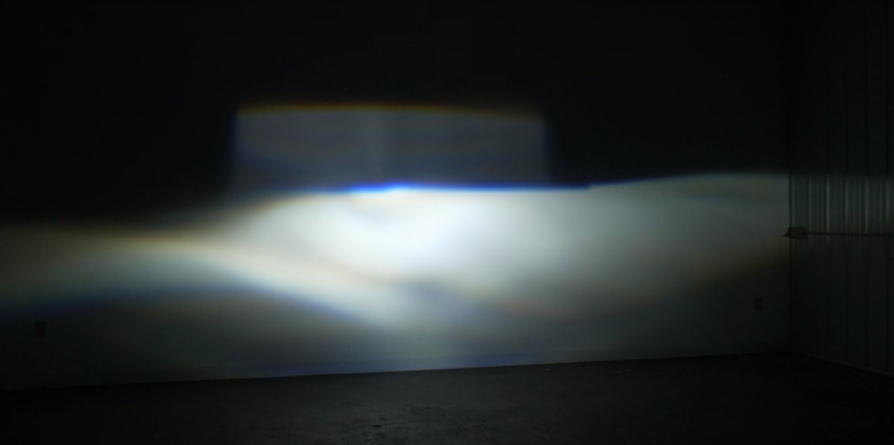

    Installed incorrectly (01):

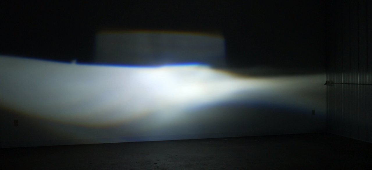

    Installed incorrectly (02):

    Your first pic the one “correctly” installed shows the hot spot dripping down and not towards the cut off how it’s supposed to be.
    Numbers don’t lie my friend. Have a good evening.

    I think your iPhone screen is throwing off what you're actually seeing. Or you've eaten too many crayons. Before you flex, I'm prior service as well and I'm allowed to give you shit.:p
    Again, I don't have any of the above mentioned LED's installed in my truck. Those numbers don't reflect what I have installed.

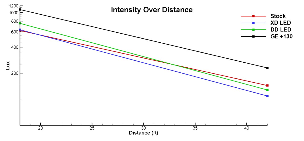

    It's already been done gents, back in June - post #1285: https://www.tacomaworld.com/threads...logen-h11-projector-headlights.589465/page-65
    TLDR - Some improvements over others, but still falls short of halogens. There's also this final note to consider overall: "5) While Diode Dynamics lists output as 'Street Legal', replacement LEDs are not yet legal, meaning they are federally illegal and will cause your vehicle to fail inspection in states that perform them."

    Thanks. Didn't realize that he just tested those in June. Definitely an improvement but still has the drop off after 31ft. Maybe not a big deal for the ones currently running DD? Light discussion is exhausting lol.
