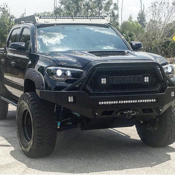

    You can technically run your Icon's with our +2 Prerunner kit!
    There are a few changes we did from the OEM 2.5 Coilover and the Custom one we offer with the kit ( different size shock, length, valving ) but they will bolt right up and still perform pretty well!
    Let me know if you have any other questions or pricing!
