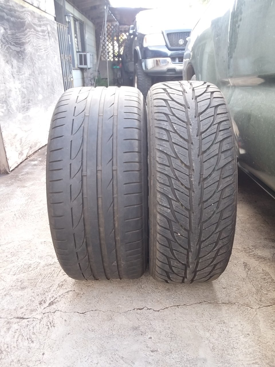

    DJM 3/4 drop 1" lower Ball joint spacers Blitz Z1-18x8.5 235/40 & 18x9.5 255/40
    20190506_173324.jpg I'm on 18x8.5 +25 (235/40-18) front and 18x9.5 +38 (255/40-18) rear @ 4/4 drop with djm mini notch. I also have a set of stock wheels 19x8 front 19x8.5 wheels on 45 series tires i think 225 and 245. Neither setup rubs under normal driving. Only rubs on the passenger side if I have 2x full sized dirt bikes in the bed and a passenger.
    The tire profile on the 19s are what I'd consider "squared" not stretched or bulging. Ill admit the ride is better with the 19s with the 45s but they just looks so skinny...
