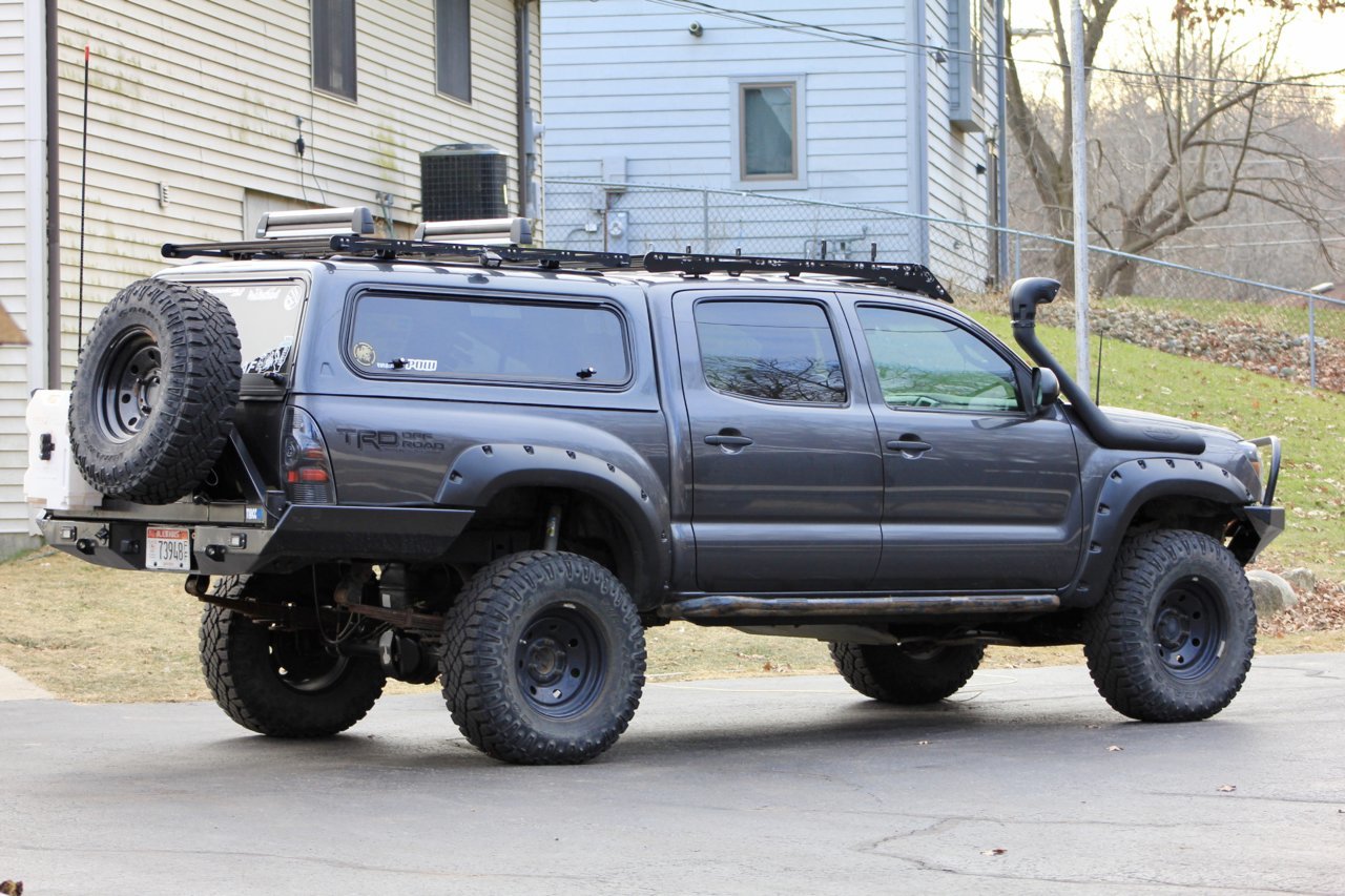

    My current leaf springs are almost flat, and need to be replaced.
    http://www.lowrangeoffroad.com/2005...f-springs-by-all-pro-off-road-4505t-ap-3.html
    I currently have those ^ but with a full high clearance with dual swingout, camper shell, bedslide, armor, etc, it is just way too heavy.
    I’m not looking for something super stiff, but I want to adequately support the weight.
    Looking at OME Dakar’s (EL096R), but open to anything. What do y’all suggest?

    Dakar heavy pack with all your equipment

    That’s what I figured, and my truck looks very similar.
    Do you remember P/N or how much you paid for them?

    I’m also wondering if they will be enough. Should I look to something even heavier?

    You have any idea how much weight you've added?

    High clearance rear bumper
    Dual swingout, two Jerry cans, spare tire
    Camper shell with Prinsu
    Bedslide, commercial flavor
    Then there’s the sliders and full skids that are split between front and rear axles.
