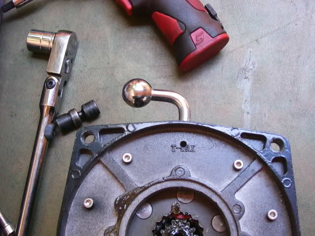

    I disassemble everything and removed every last bit of that junk. I also resealed the solenoid cover with some ultra grey silicone. The solenoid has a problem of being improperly sealed allowing moisture inside causing corrosion at the terminals. There are writeups everywhere about how to service the Smitybilts and how to do reseal the solenoid. There's a few here at TW as well I believe.
    One interesting note about the winch when I took it a part. There was a "T-Max" inside the lever cover that is part of the casting.
