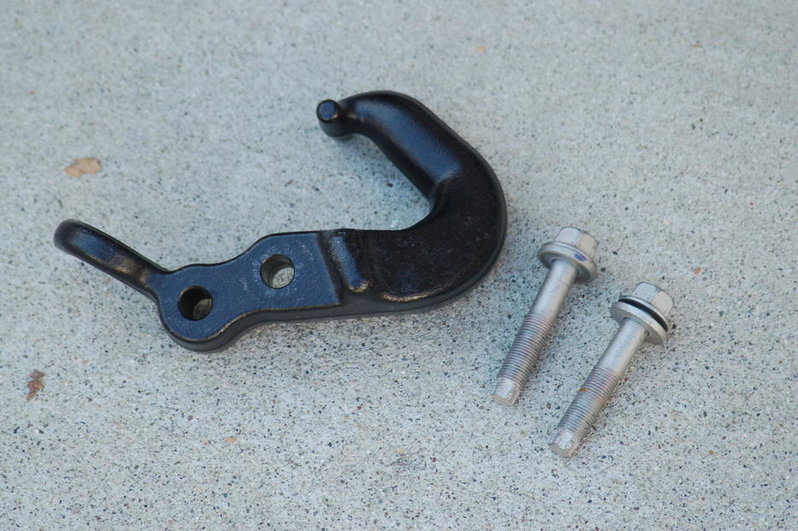

    ^^ this... Does anyone have anecdotal/actual evidence of the front recovery point failing? sure, I wouldn't hang the vehicle from it but Toyota does provide the OR models with that big beefy hook, it certainly implies that one can apply a great deal of force to it in a recovery attempt. The sport/SR5 models come with the above recovery point, it's like 5/16ths steel, and wider than that at the thinnest part, definitely thicker than, say, chains I've used in the past. There are several vendors here that sell beefier brackets than the factory one, and they attach with the same bolts.
    Has anyone ever heard of/seen a failure/damage to frame?

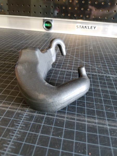

    Correct the welded on drivers side loop is indeed the tie-down for transport, but the passenger side fixture is a tow hook. On OR models the point looks like this

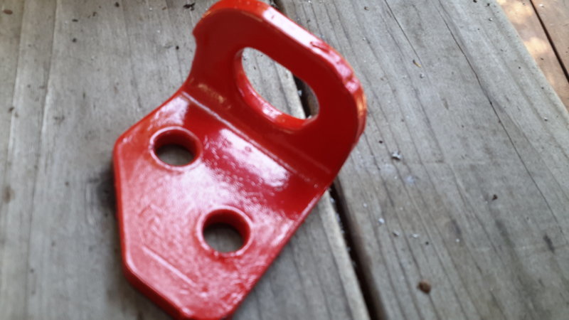

    On SR5 and sport models it looks like this,
    Owners manual says the truck can be towed from this point
  4. Jun 11, 2016 at 1:11 PM

    I bought one of these used off here for $40. Bolt right up, hardley even noticeable and they are forged, so very strong.

    I have much more faith in the OR hook than what comes on the rest of the range. I would spend the money on the hook.

    And no only the OR models come with the hook, the sport and SR5 models come with the bracket pictured
