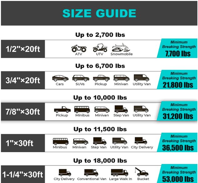

    Safe to say you want at least 3/4" to 7/8" Kinetic rope with "soft shackles" for your midsize Taco. A winch dampener (blanket) in the middle couldn't hurt either.
    Lots of videos on YouTube to guide you....

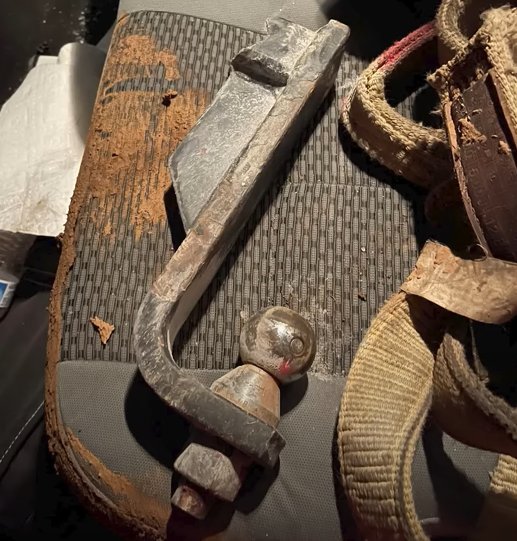

    That guy got what he had coming to him, let's not use his stupidity to stoke fear. He was standing directly in the path the stuck vehicle would take if it came unstuck, and didn't step away from the strap, huge mistakes.
    Using a rated receiver hitch is clearly more reliable than some aftermarket bumpers and how some people choose to attach them.
    The reality is that taking a serious approach to recovery brings safety for the most part. And don't rush a recovery. OP, watch Trail Mater and Matt's Off Road Recovery on YT, you'll learn a lot.
    Forged steel D-shackles are extremely strong, I just try not to use them to join 2 nylon straps together, because if 1 strap breaks, you have a steel missile. Keep them at the vehicle hard points. I still have to buy a couple soft shackles

    That was an extreme example but a good warning example.
    That truck was incredibly stuck in the mud, and the worst possible "drop-hitch" drawbar was used, putting torque/ bending force on the receiver tube, instead of a straight tension:

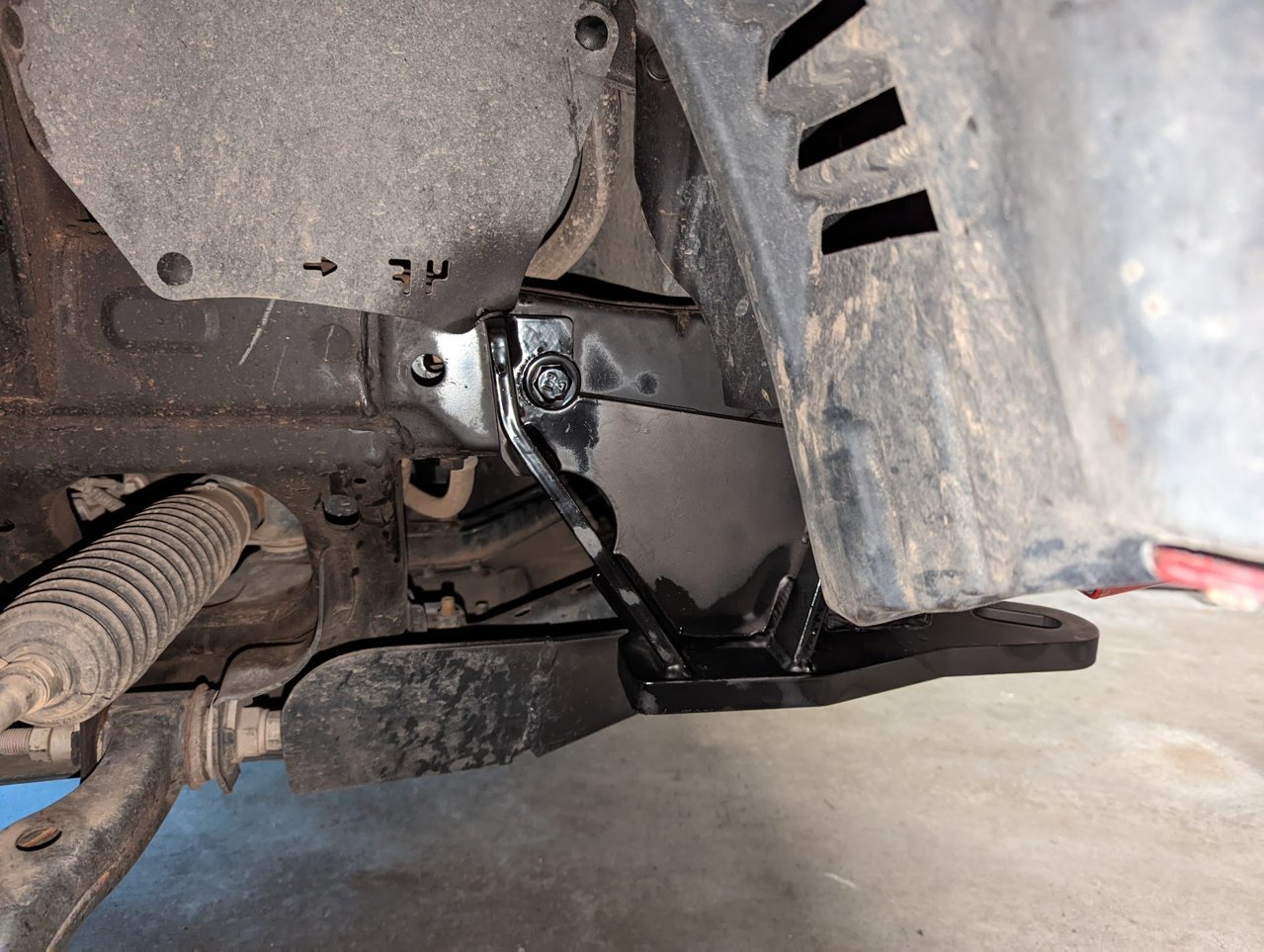

    Red is nice and all, but I like stealth as you mentioned. Did the same to the TRD skid inboard of it. The paint was still drying here:
