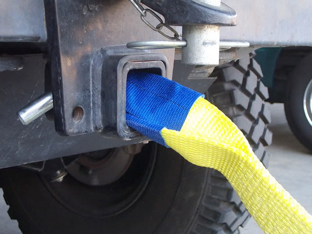

    • You may be able to wrap the strap around a hitch, but I would not put it IN the hitch. I have seen a few people who have bent the pin, which then had to be cut out. Getting a tow hook or D-Ring adaptor to go into the hitch is a better idea. Here is an example of a D-Ring adaptor and how a recovery strap should be hooked up to one:

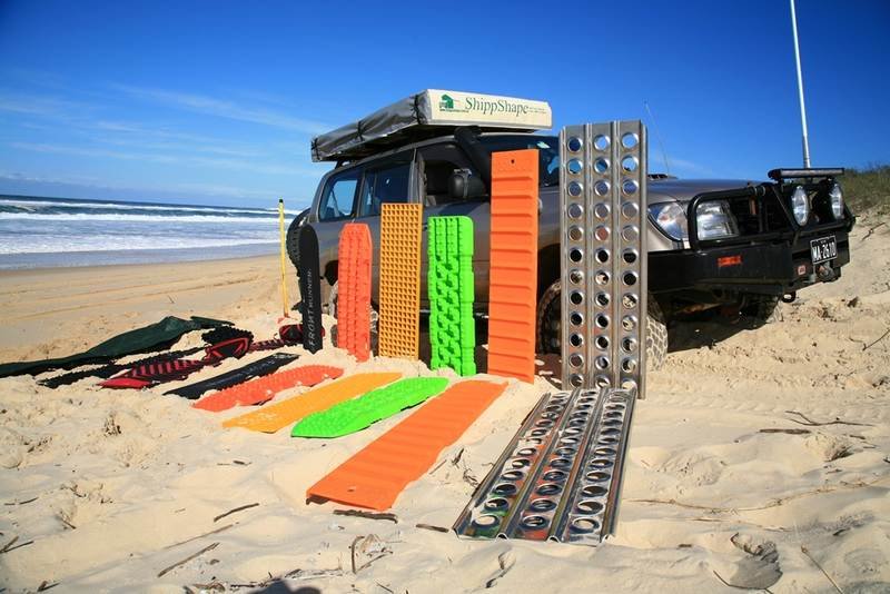

    Using your recovery boards

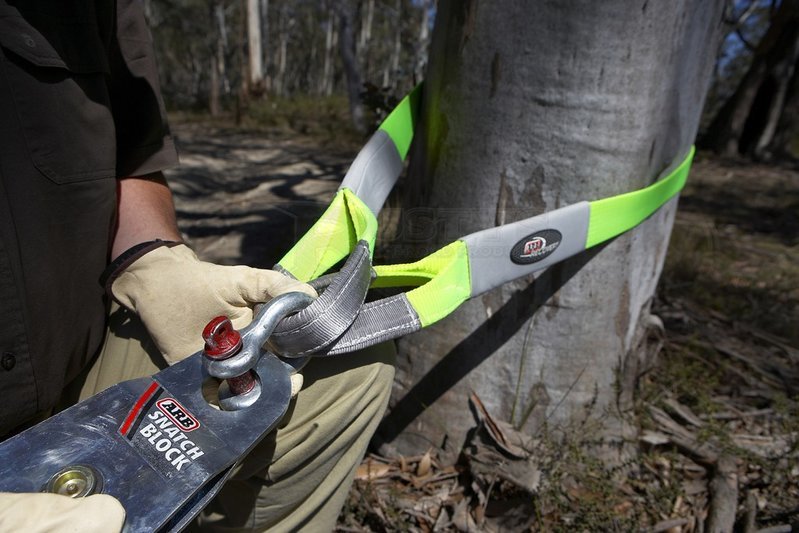

    Tree Saver Strap
    A fancy name for a short (usually 10 foot) recovery strap. It is used for wrapping around a tree to use it as an anchor point without damaging the tree.

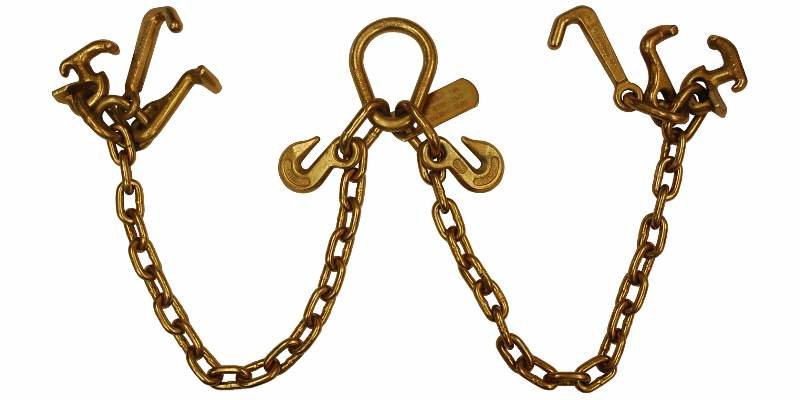

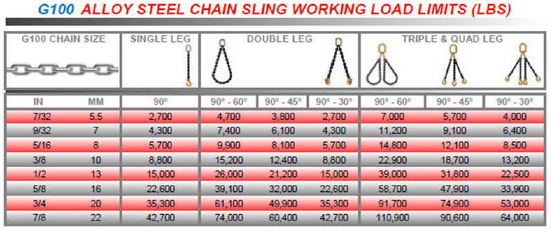

    Chains for recovery
    Chains are useful in some situations where fabric straps are not. If you must connect to a frame rail or axle for a recovery when no other points are available or feasible in the circumstances, using a chain is a better idea to keep the strap from being cut on sharp edges. Grade 80 or 100 chain is preferred for recovery use.

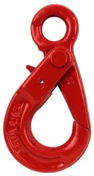

    Hooks
    Hooks are still used on chains, winch lines and in recoveries. Hooks come in open, with latches, or hooks that when pulled, keep the hook shut.

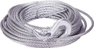

    Winch cable
    Winch cable is metal, heavier, but less susceptible to abrasions. Heavy gloves should always be used due to the possibility of frayed metal cable that will easily slice through your skin.

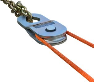

    Snatch Block
    A snatch block is a pulley that is used to redirect the winch cable to an object.
    If a snatch block is used with steel winch cable, it should never be used with synthetic rope again. The steel cable creates sharp grooves and spurs on the snatch block that will tear apart the synthetic rope.

    Tree Saver Strap
    A fancy name for a short (usually 8-10 foot) recovery strap. It is used for wrapping around a tree to use it as an anchor point without damaging the tree.
    Chains
    Chains are useful in some situations where fabric straps are not. If you must connect to a frame rail or axle for a recovery when no other points are available or feasible in the circumstances, using a chain is a better idea to keep the strap from being cut on sharp edges. Grade 80 or 100 chain is preferred for recovery use. Grade 80/100 will be expensive, but quality is what you need in recovery gear.
    Hooks
    Positive Locking Hook As you pull, it makes sure that the hook is shut.
    Hook with latch
    Open Hook

    Winch cable
    Snatch Block
    If I snatch block is used with steel winch cable, it should never be used with synthetic rope again. The steel cable creates sharp grooves and spurs on the snatch block that will tear apart the synthetic rope.

    Traction Boards
    Many different brands of traction boards are on the market these days. They offer the ability to add additional grip when needed to get you un-stuck. They can also be used as ramps or to bridge ruts when stacked appropriately. It is a good idea to have a string or rope attached to the end of the boards so they are easy to locate after using them since they easily get buried in sand/snow/mud after use.

    Hitch pin
    The hitch pin that you usually put through a hitch is a great way to attach a strap to a hitch receiver. It is a horrible idea to attach a strap to a hitch ball. The ball can easily become a projectile hurling through the air at 100+mph, going through windshields and bodies.
    Frame Keys/J Hooks
    These are items that you will more likely find on a wrecker/tow truck. The frame keys fir into the holes on the frames of vehicles to act as a recovery point. The frame hooks/J hooks are a basic hook that allow you to hook to more items for recovery.
