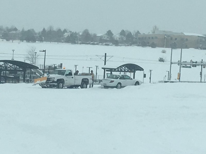

    Nice work @3378jakesr5!
    Now to get out there and recover all these stuck cars!

    What hasn't been modified?
    The car was high centered
