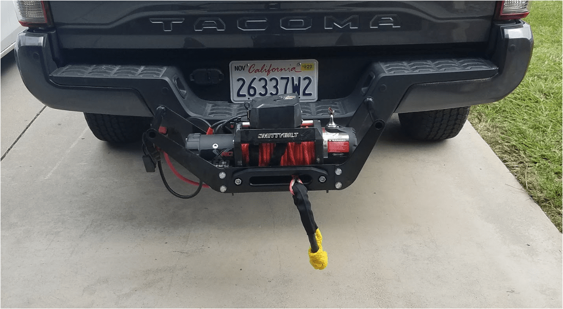

  16. Jul 10, 2020 at 9:51 AM
    #136
    JVL1985
    JVL1985 Well-Known Member
    Nov 25, 2019
    #311669
    299
    2019 Tacoma Double Cab, short bed,4x4, v6, TRD Off-road
    I just bought some soft shackles and I'm wondering if they are safe to use directly looped into the winch line eyelet like the picture shown below instead of using a winch hook.
    I have a couple of standard Warn and Smittybilt winch hooks I can use but I was thinking about taking them out of the equation.
    This is on my truck. I would like to run it like this but wondering if it's better to use the winch hook?
  17. Jul 10, 2020 at 10:53 AM
    #137
    doublethebass
    doublethebass aspiring well-known member
    Jan 1, 2017
    #206252
    3,351
    Antoin
    Minneapolis MN
    ’17 6MT Pro
    It’s best to do it exactly the way you have it, without the hook. The soft shackle is less of a projectile if things go wrong.
    C41n and Grindstone like this.
  18. Jul 10, 2020 at 11:15 AM
    #138
    JVL1985
    Nov 25, 2019
    #311669
    299
    That's what I figured. But I saw a bunch of expensive winch hooks and thimbles on here and it got me second guessing my cheap ass setup. The only way I can see this being bad is abrasion at the connection possibly creating a tear in the shackle. But the shackle has a protective sleeve and the eyelet doesn't seem to have any sharp edges so I think I'm safe.
    doublethebass[QUOTED] likes this.
  19. Jul 10, 2020 at 11:48 AM
    #139
    Scott B.
    Scott B. Well-Known Member
    Nov 11, 2014
    #142118
    4,244
    Scott
    Georgia
    2015 ACLB SR5 4x4 Expo
    The problem running like this, while not having a hook is a good thing, is the bend radius you subject the soft shackle to. Ideally, you don't want to bend the shackle line tighter than 2 1/2 times the diameter. Bending around the thimble is significantly smaller than 2 1/2 times diameter.
    That being said, while the marine industry, climbing industry, etc. follows the guidelines, it seems a lot of off-road people (and industry) do not follow it strictly.
    I am searching for the definitive answer, but have yet to find it.
  20. Jul 10, 2020 at 12:14 PM
    #140
    cwadej
    cwadej Ballerina Award winner
    Feb 23, 2018
    #245352
    1,211
    Right Here
    2011 Access Cab 4x4
    I've never seen a manufacturer of line say not to use bends smaller than 2.5d. I've seen lots of suggestions, but never a "do not do this" from the maker of a rope.
    You may have, which if so please show me. I wouldnt be surprised as you have way more experience in the field than I do.
    also, and not related to anything you said...
    please remember that synthetic winch lines DO store energy and WILL snap back when broken under tension.
