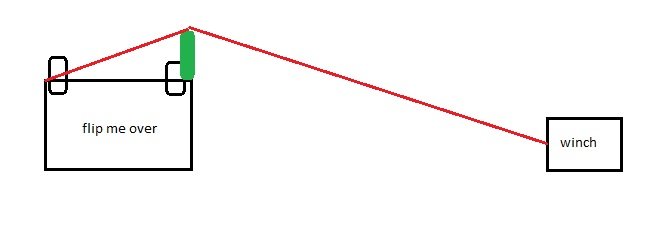

    using a board (i use a 4x4x36) lengthwise between the rocker panel and winch line of the upside down vehicle will help pull it over and keep it from getting tangled on the under-carriage. Learned from a wrecker driver, said it makes life easier, never drags, just flips.
    I always have one in my truck.

    We used two winches so that the truck was set down easy and didn't run away once on 4 wheels...

    Which does nothing to counter what the board is for, as shown by the pulling line getting stuck under something on the truck.
