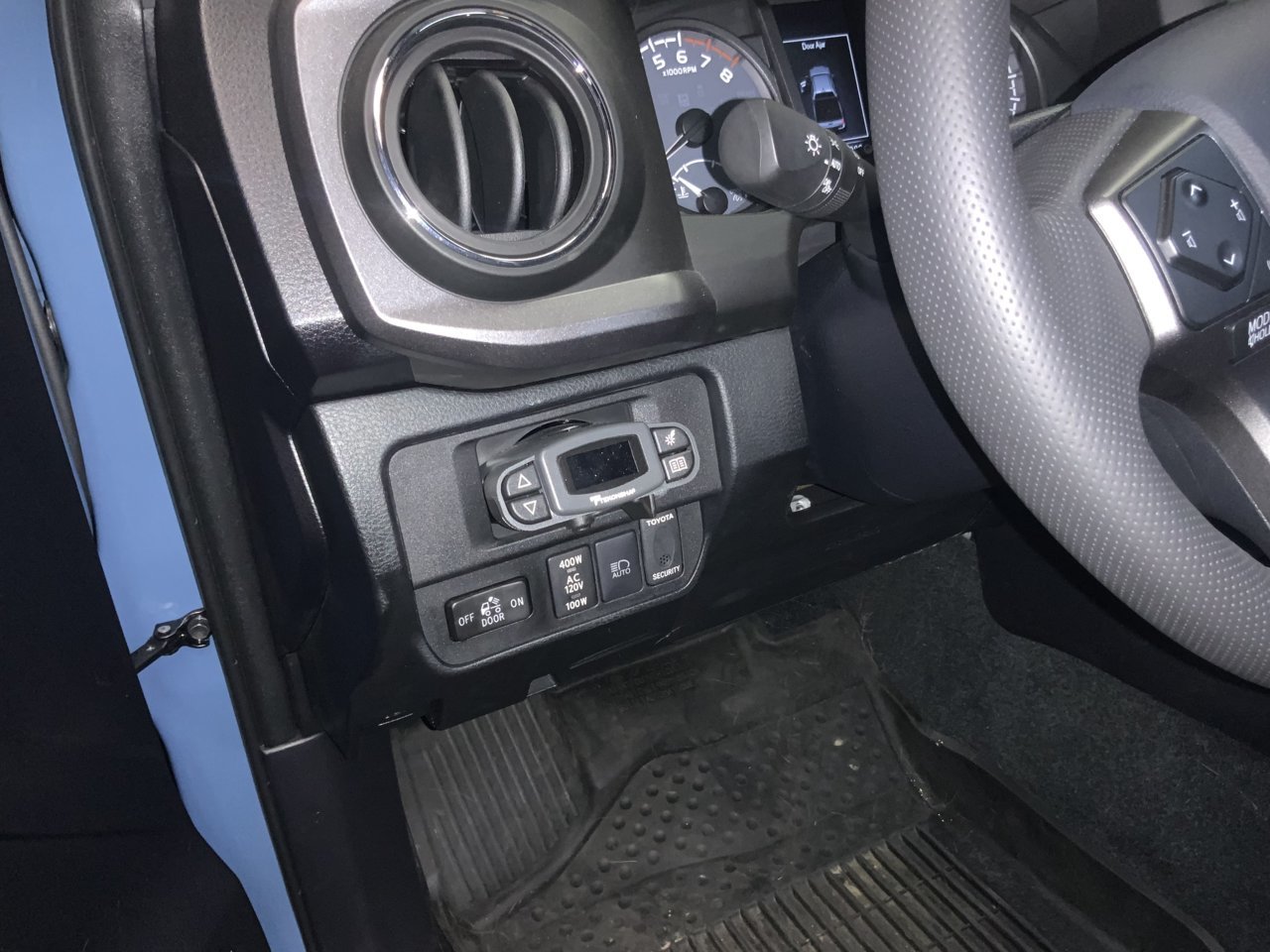

  2. May 9, 2019 at 8:49 PM
    BRFab
    BRFab Well-Known Member
    Sep 24, 2018
    #267226
    248
    BC
    '19 Alien Grey TRD OR
    This is how I did mine as well. Dremel the shit out of the back of the blank so it fit snug, then drilled for the retainer nut just enough to hold everything tight.
    The 3017-P is the harness I used, clip the harness and butt splice and heat shrink it all together.
    Took about an hour all total and that was being careful to not damage any finishes.
    Love it. Looks factory clean.

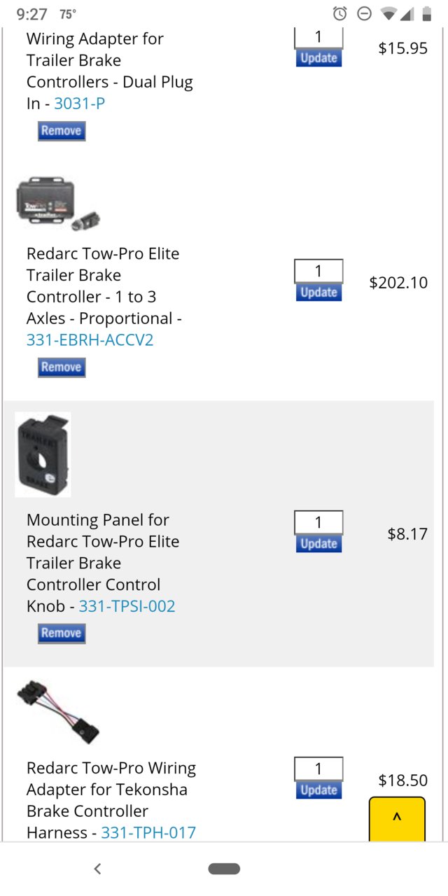

    So here is my purchase plan for complete plug and play. Does this look right?
    stealthmode likes this.

    Got mine hooked up last night. Check your glove box for the factory supplied pigtail for your trailer brake harness before you buy one. I bought the one mentioned here and then found the factory one during the install.

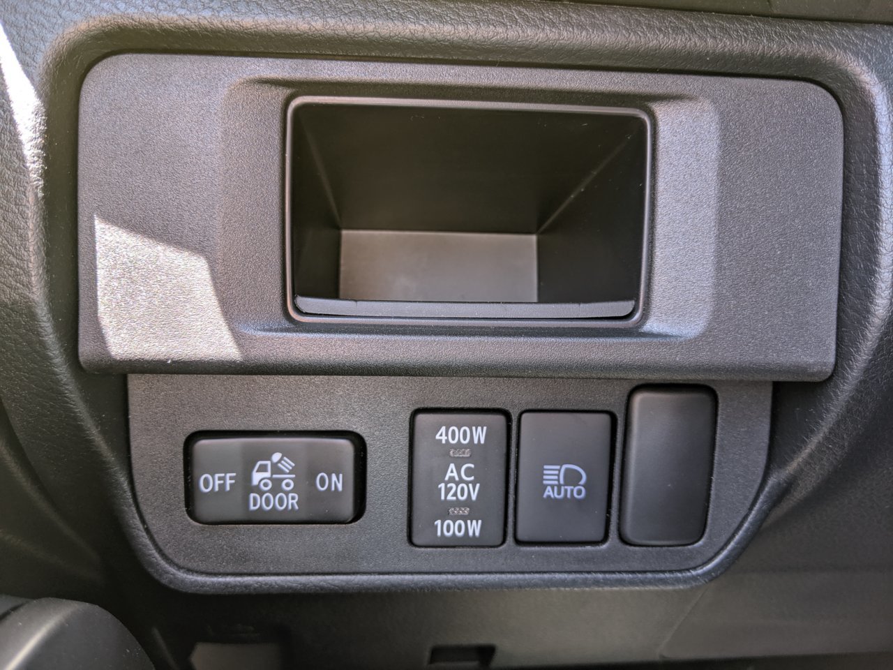

    I checked the glove box the other day. If there isn't one in there (2019) should there have been? Should I go back to the dealer and ask about it?
    From what I've seen it looks like every controller needs an adapter. Why didn't Toyota just pick a connector that fits something (anything) existing?
    Also it occured to me as I was going to sleep last night that the little mounting knob thing is for the 'short' switch slot, and the one space I have empty is a tall one.
    I guess I need to hunt down a meso stage 2 so I can eliminate the ect button and replace it with this.

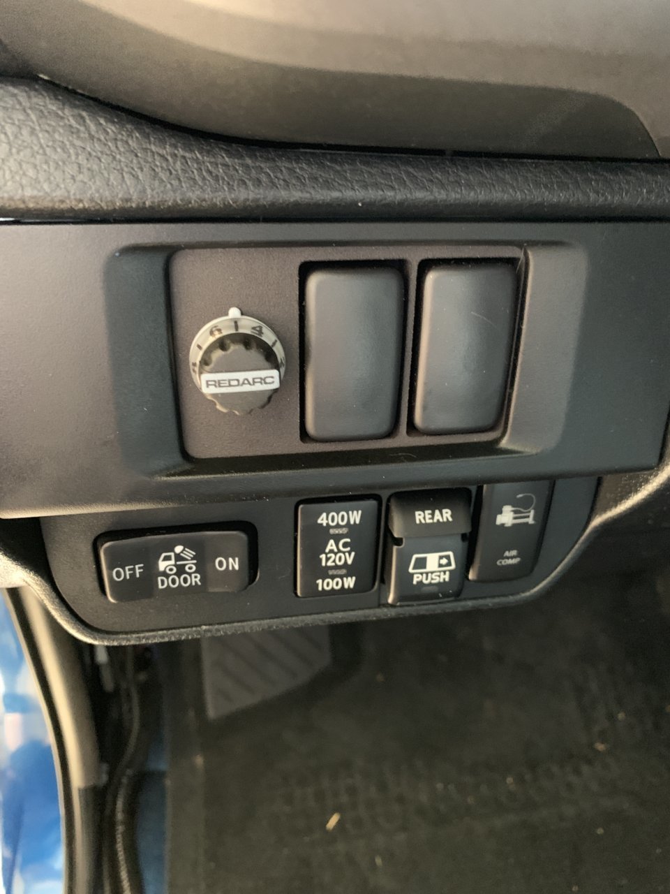

    @s7726 I ended up using the panel from this thread:
    https://www.tacomaworld.com/threads...on-2017-trd-sport-step-by-step-w-pics.569685/
    Now I have my Redarc mounted, and gained 2 extra switch spots for additional lighting.

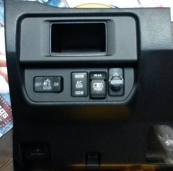

  13. Mar 5, 2020 at 9:05 AM
    MESO
    MESO Major Modder Vendor
    Feb 16, 2015
    #148809
    16,295
    State of Jefferson
    2016 DCLB TRD HELLCAT SWAP
    Here's a prototype brake controller panel I just made for a customer. Uses the Tekonsha with a custom lever. I hate how far it would have to stick out with the stock lever.
  14. Mar 5, 2020 at 9:06 AM
    mcharfauros
    mcharfauros IG: mcharfauros
    Apr 21, 2017
    #216893
    4,256
    MO
    2017 Black TRD OR DC
    Dumb Truck Thangs
    Well shit, there @MESO goes again, doin’ @MESO thangs. Nice work brotha, may revisit the Tekonsha
    MESO[QUOTED] likes this.

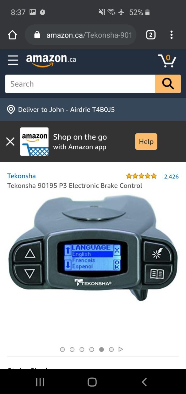

  15. Mar 5, 2020 at 7:39 PM
    stealthmode
    stealthmode Well-Known Member
    Dec 7, 2014
    #143869
    2,409
    Alberta
    2016 Short N Stubby Bed- MGM
    Front and Rear lifts Tires ECGS bushing Lots of other crap +HP sticker
    I need this! Although the lever I have looks a little different on my tekonsha....did u print him a longer one? Screenshot_20200305-203754_Chrome.jpg
  16. Mar 6, 2020 at 10:52 AM
    MESO
    Feb 16, 2015
    #148809
    16,295
    State of Jefferson
    Custom longer arm was made in order to get the brake controller flush. The increased leverage actually helps fine tune the brake too.
