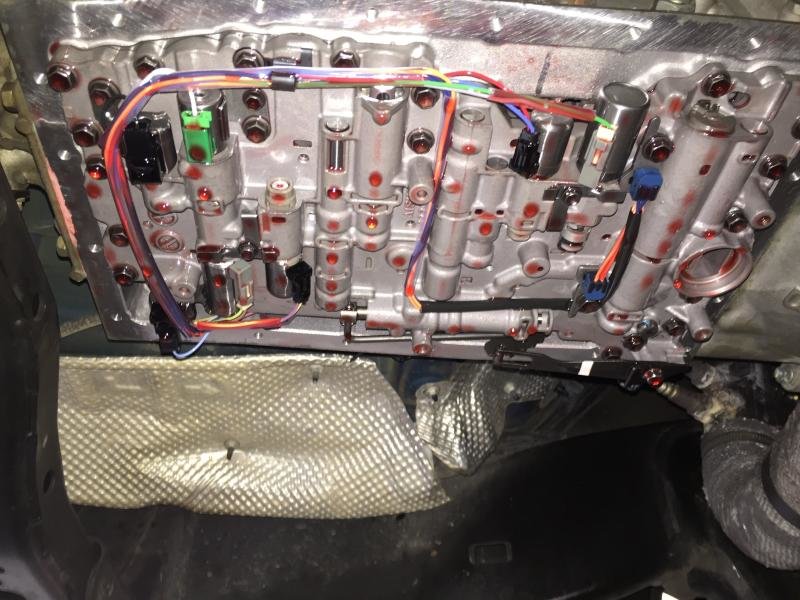

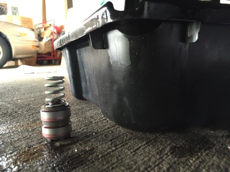

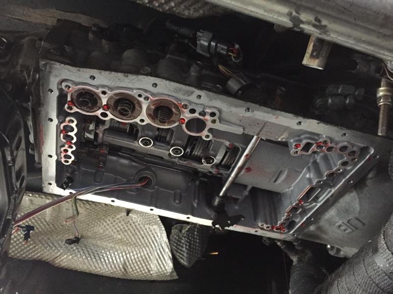

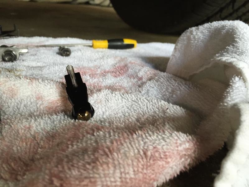

    Some photos during install.
    Before removing valvebody
    F6119EA0-ACF6-44E9-AC71-2ACC8C429123_zps_ed729c9094890c11465a238e2926e784b53531c6.jpg
    Afte removal.
    24103818-BF34-4F65-9E45-A6C36708BA46_zps_9983b747e3d9b0efe900e6ecc95039e35c08f23f.jpg
    As u can see only two items came off that was behind the valvebody. The infamous ball check valve with the tiny spring and the smaller springs/piston. I used quite a lot of trans assembly lube to keep them in place but VERY LITTLE trans assembly lube was needed out of the whole tub I purchased(16oz). It was very helpful on using it for the pan gasket so it would stay in place as well.
    F78DAA6A-207F-4F1C-8BBF-B6429D6BFAD0_zps_28f8b80a0d1c4aeca33f65c73a95c115d44dad22.jpg
    00A8B100-ED17-4CB1-A8A7-574D6F6296A0_zps_ff1c72d56ffcf81b510ef0de212bdeefd31c5f61.jpg
    Forgot to take photos of the one they sent. Install was pretty easy too. Just take your time as lots of fluid will come out. Make sure you have a pan to collect the oil because it will be constantly dripping. From the start of draining the pan and even to the install of the new one.
