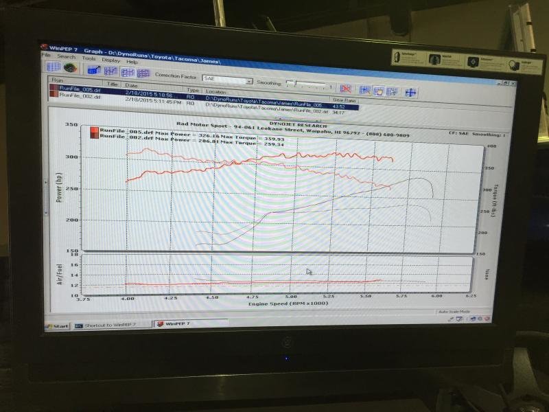

    17CC621D-EBA2-4599-8870-02764BEEE981_zps_676b62e8271176dfd37815aa69318f3f869b2ed3.jpg
    Done on a dynojet
    pretty much at sea level. 7.5psi WG spring regulated. Run 2 was on 3rd gear, run 5 was on 4th gear. Had trouble trying to kEep it from downshifting so he had to ease it in for each run.

    Did you happen to get any datalogs during the runs? Those would be great for Gadget.

    Damn never thought of that! That definitely would help him. I plan to return to the dyno but at another shop that runs a dynapack. I want to compare the numbers from the different dyno machines. I will do so then when i get the chance.

    whoops. yes best dyno was at 326.16 RWHP/ 359.93 RWTQ/ 7.5 PSI WG

    paid 120 for 4 pulls... 3 of um in 3rd gear, then i asked him to do one in 4th gear.

    Have you gone past 7.5 psi?

    no. All runs were done at 7.5psi

    Im using the UCON EMS from URD.
    here are the videos.
    3rd Dyno Pull done in 3rd gear..
    http://youtu.be/MFREvJhZ8ew
    this run made 315.65RWHP/317.73 RWTQ
    4th Dyno Pull done in 4th Gear..
    http://youtu.be/eqTCghHxn48
    and finally 326.16 RWHP/ 359.93 RWTQ
