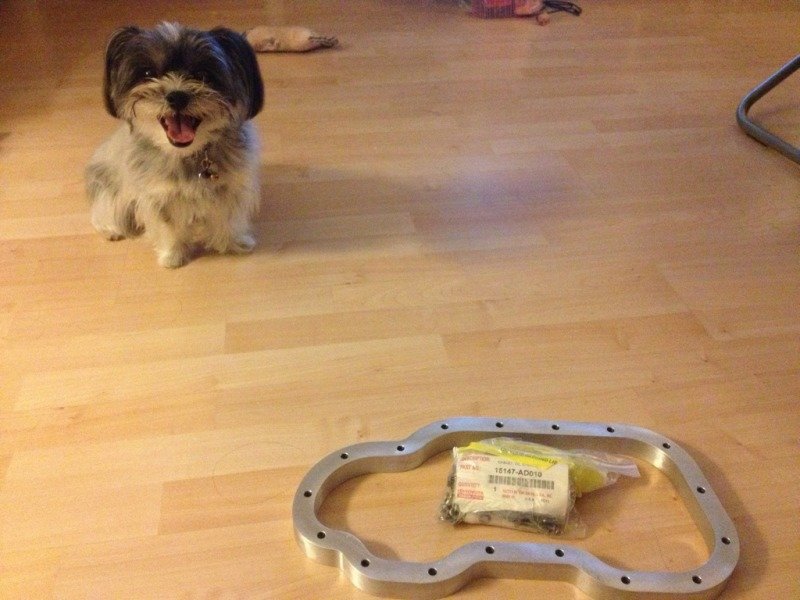

    Bought Oil pan spacer from coupe that came in today! Install will
    Be next oil change.

    That right there is a piece that any one with the shallow oil pan should get!

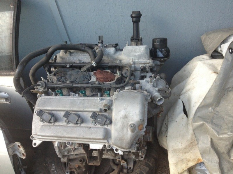

    So I picked up the engine today. Seems to turn just fine but will start the tear down maybe later this month since I got some stuff lined up. Here's a sneak peek.
    420D70DD-8C37-48CA-AB9E-B0DED41089DB-466_e573d0a56b11b0537a8f577cc5cb8194123da2d7.jpg
    As for the hot tubes setup from powerfab, Jeremy (the owner) will be calling me to set up the order and take down some info.

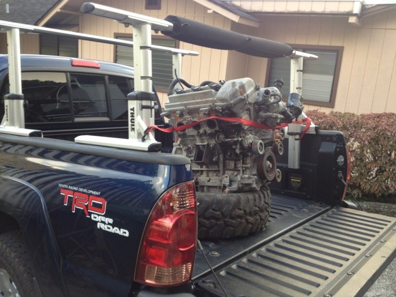

    So I had the motor sitting in my truck and tried mounting it to the stand today. I put the stand together fine up until i mounted the brackets onto it. The damn bolts were too long and it was missing hardware. Anyways that was an Easy fix.
    Now the mounting...Didn't have a engine hoist so my buddy and i ended up going to home depot, picked up a ratcheting tow strap And had it hanging over a 4x6 beam. Talk about Brokanic build 101 right there. We then had it suspended ready to bolt on to the stand but realized that I forgot to buy the mounting bolts. Damnit another set back. So now it's jus sitting on a dolly waiting to be worked on. Gonna pick some up tomorrow and hopefully start the tear down this week.
    To be continued..

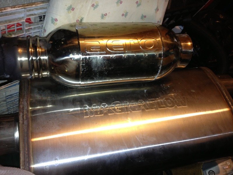

    Scored some hand me down goodies this weekend....
    Woot! My brother changed his exhaust setup so i scored an aero turbine and magnaflow with 3.5 inlet. Used for Less than a month.
