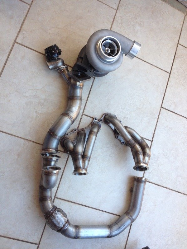

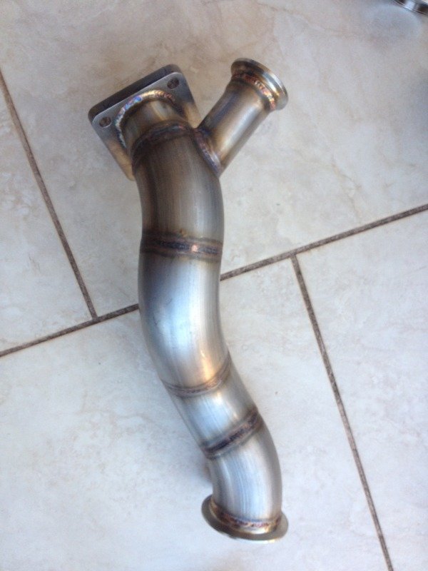

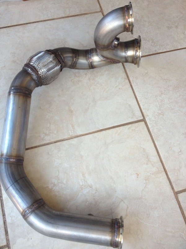

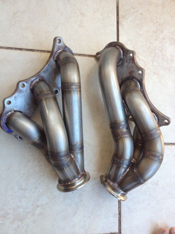

    Thank you Jeremy at Powerfab! Especially Alex with his awesome fab skills. Photos look great but looks even BETTER in person.
    You get the idea...

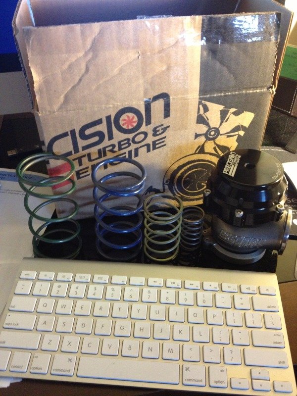

    Forgot to mention I decided to go with a 46mm Precision Turbo Wastegate. Includes 5 color coated springs. Blue 18 psi, Green 9psi, red 6 psi(not shown. Inside wastegate), yellow 3psi, and a natural colored at 1.5psi.

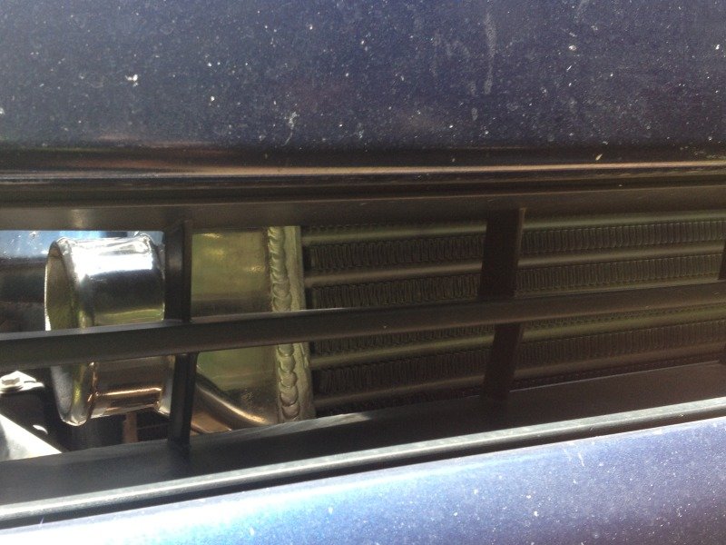

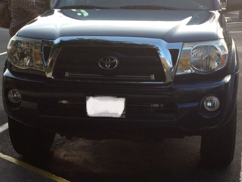

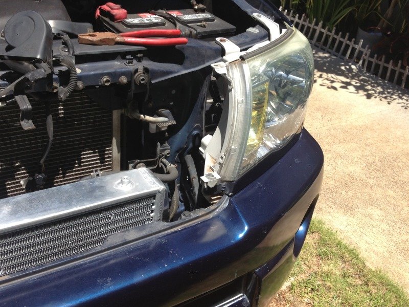

    Got my inter-fooler mounted today. Man was it hotttt.
    Used some L brackets and mounted behind the bumper.
    Tada....had to trim behind the grill so it could fit.

    Torspd Custom Turbo kit [] Borg Warner 9180EFR Turbo [] Haltech Elite 2500 [] TiAL Q BOV [] TiAL V44 Wastegate @ 15psi [] CP Pistons [] CP Carrillo Rods [] ARP Head studs [] ARP Main Studs [] ARP Header - Head Studs [] Ported Heads w/ 1mm oversized valves intake/exhaust [] Brian Crower Forged Stroker Crank [] Darton M.I.D. Sleeved Block [] Kelford Camshafts [] Torspd 160* T-stat mod [] APR Large Fuel Rail [] Walbro 460 LPH E85 Fuel Pump [] FueLab FPR [] APR T56 Conversion Kit [] KP RACING Built T56 [] McLeod Racing Custom Twin Disk Clutch [] One Piece Aluminum Driveshaft [] MGW Shifter [] Custom lowering kit [] Ohlins Front Coilovers [] QA1rear shocks [] Custom Ron Davis Radiator [] Dual SPAL Electric Fans []
    That looks really good. The thing I like about it most is that your setup leaves plenty of the radiator unblocked.

    Thanks bro :cool: I like it too. I had it set at that height due to where my piping would route to. Where its at now, I have a lot of clearance.

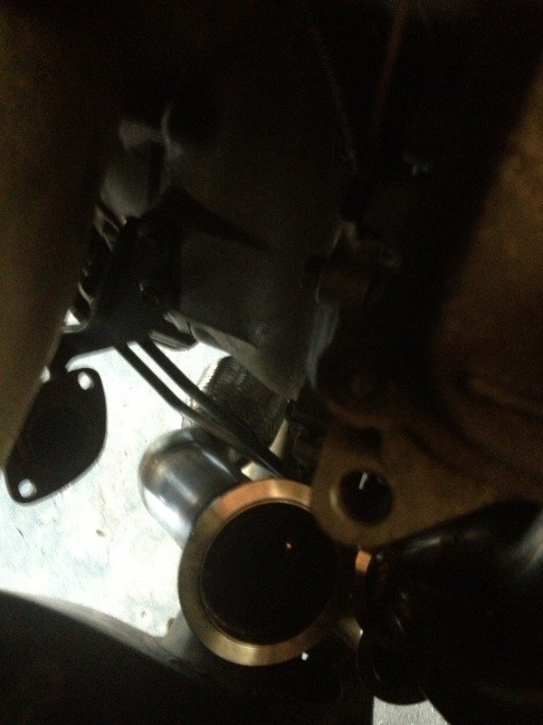

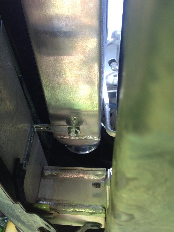

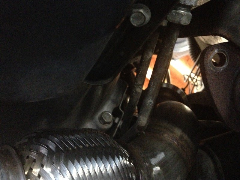

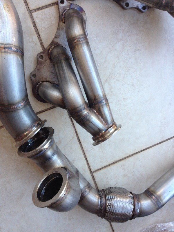

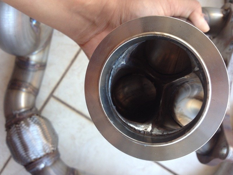

    Today I did a test fitment with the setup I got from power fab to check for any fitment issues and only one came up. Since this is the first to be tested on an auto, I figured I'd share my findings. After connecting the driver side vband to the header and collector I attempted to do the passenger side next. Only issue was that the lines for the auto transmission are preventing the collector pipe line up with the passenger header. Not too big of an issue. Since part of the lines are made up hoses toward the front of the vechicle, that will be my fix for this issue. Plus it makes an opportunity to install a transmission cooler!
    Here are some photos....
    This I from under the vehicle on the passenger side where the lines are preventing the collector to line up.
    Top view from engine bay

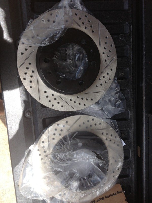

    And some rotors and pads came in from r1concepts today. Brakes were going bad and rotors had some scoring so I ordered these for now. Never had an issue with r1concepts before so that's my reason for ordering from them. Will
    Be purchasing a BBK in the future.

    Doesn't actually look like to much a problem. Can you carefully bend the lines with out kinking them?
    Or do you think that you'll need to get braided stainless lines? <<< If so, Jegs likely has the adapter fittings necessary to do so.
    Picked up some R1 Concept rotors for my mom's Hyundai as well. :thumbsup:
