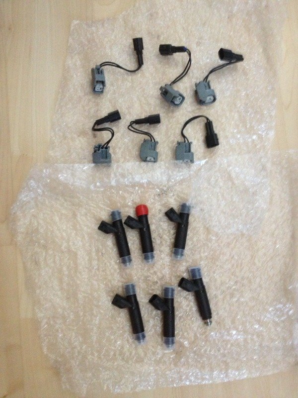

    Another piece of the puzzle that came in this week. Some urd injectors.

    1000cc injectors ?!?! Good god, lol
