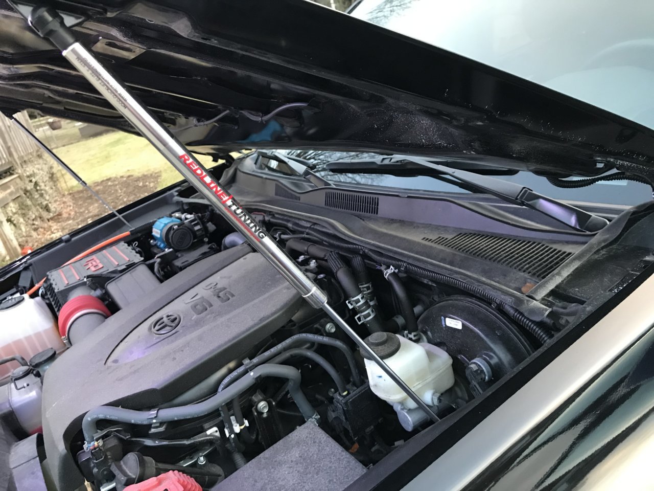

    The instructions are very clear and accurate. Installation is easy if you can follow directions.
    70444B92-C407-4531-8DFD-1E08458F89ED.jpg 9477511C-F72C-41F3-AEE8-244A65F4948B.jpg
