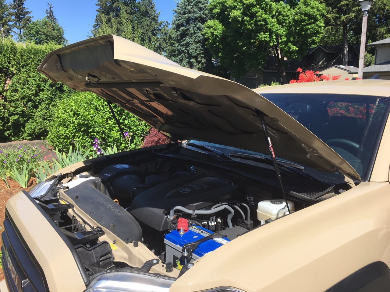

    I like mine. Easy install, just follow the instructions and don’t go cowboy crazy.

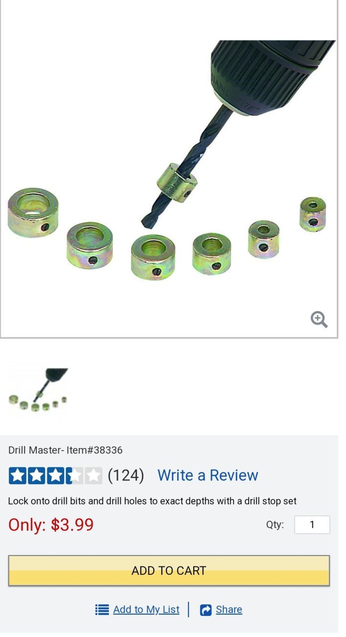

    I tried using one of those. It still slipped and almost damaged one of my other projects i was working on. Now i dont trust them.

    I wrapped my drill bit with a little masking tape for a depth gauge. Worked just fine.

    Most drills will accept the bit so you only have a small portion of the drill bit exposed. Then you do not have to worry about drilling through the hood. You can also snap the bit off. I always save my broken bits for a application like this. The other suggestions work as well

    No issues for me installing. I measured, drilled and painted one evening and finished up the next day. I used the metal collar drill stop since I had them on hand and have used them in the past with good results.
