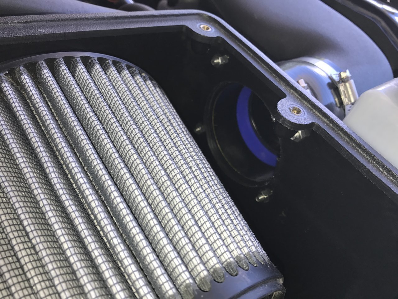

    I didn't get to run the Volant at all but I will say that I believe AFE is a better built intake as I had to Dremel every hole on the Volant intake to fit properly and where the MAF sensor mounts the screw holes were off so one screw was on a terrible angle and cross threaded just to mount the mass sensor while with the AFE I didn't have to Dremel a thing and everything lined up perfectly :thumbsup:
    And I would be lying if I was the first to put a Volant ram on a AFE ;) Thanks to Murderface on XR-Underground and Lord Helmet have done it so using that idea for mine as well :cool:

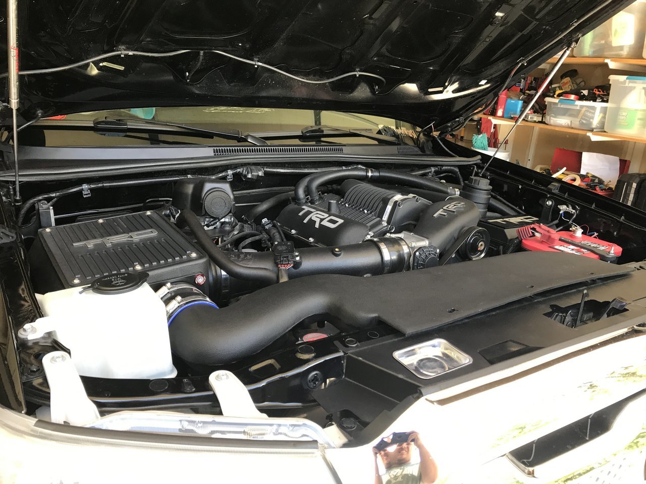

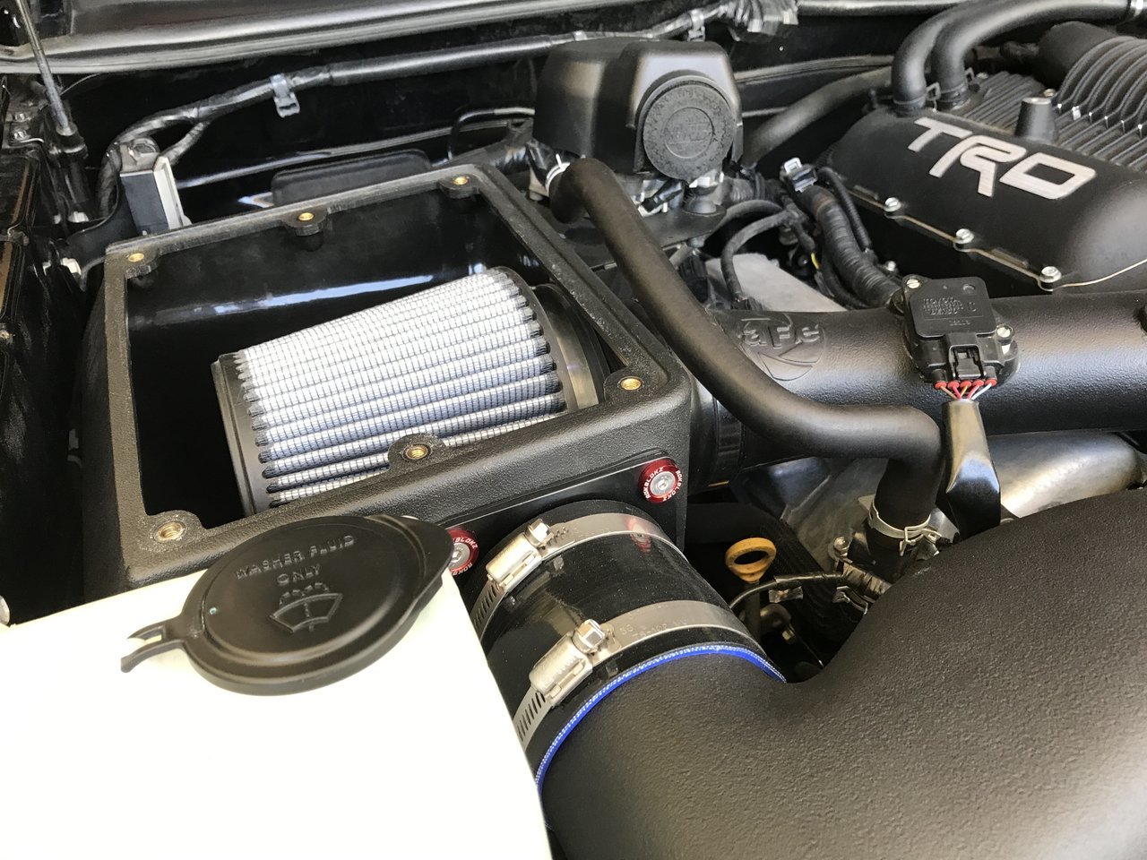

  17. Aug 21, 2017 at 3:19 PM
    #17
    WorldWar546
    WorldWar546 Baja Member
    Mar 22, 2013
    #100310
    297
    Anthon
    Utah
    TRD Charged '14 Black TX Baja
    TRD Supercharger And a lot of rice n chrome

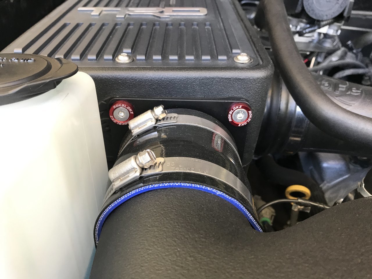

    Got it on finally lol!!
    Used a 3-1/4" hole saw to cut in the box
    Bolted on this
    Attached Volant to it and now good to go!... except need to get new plastic retainers to hold the ram to the body lol!
