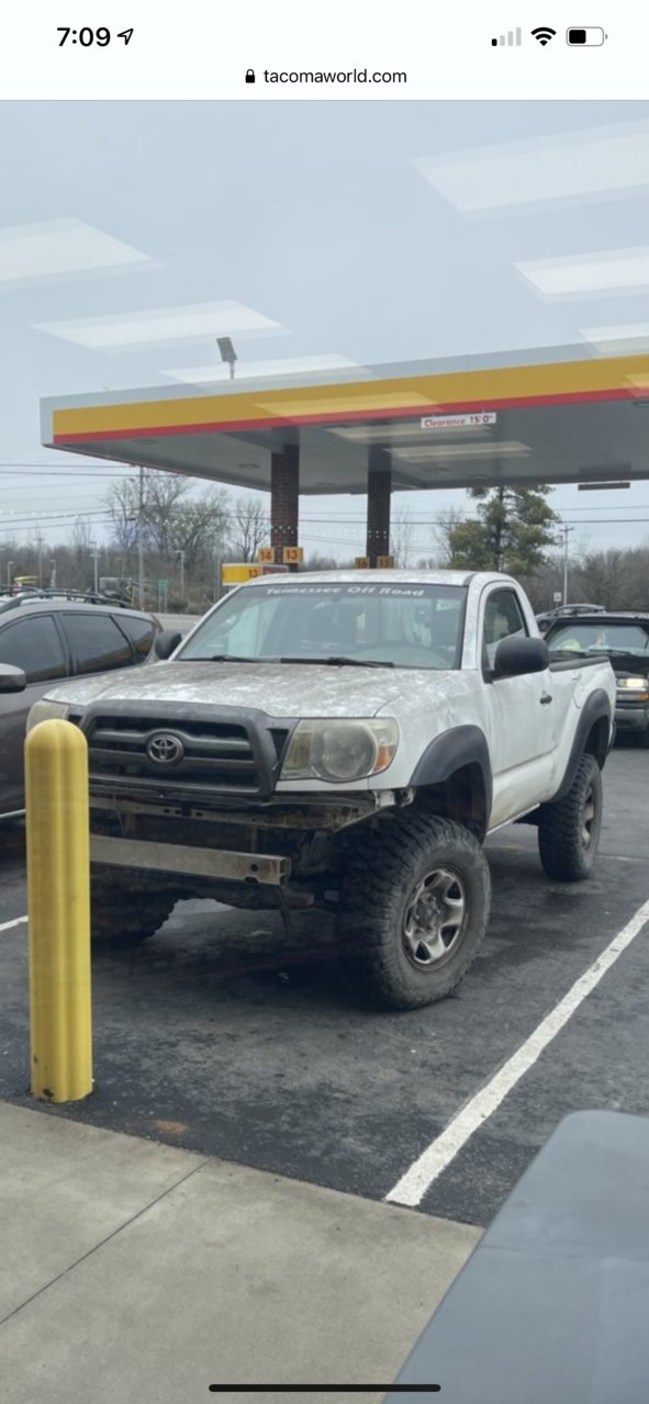

    Okay so been hunting my mom a truck to use around the house/possibly me a dd when I stumbled upon......
    https://www.tacomaworld.com/threads/what-is-my-truck-worth.710454/#post-25266807
    After some communication with @Son of Liberty decided to ride up this past Saturday almost decided it wasn’t for me, but went for it so here we are.

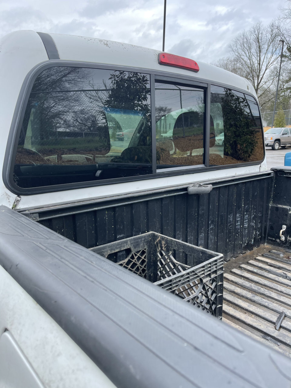

    First repair was get a new sliding glass installed, tighten down a loose clunking bed bolt and some old led tag lights/bulbs I had replaced outta my 05.

    Where'd you get the sliding glass?

    Had it installed at a local glass company it’s aftermarket but I’m okay with that this trucks use it may happen again. I can look at the brand if you want?

    Please. I need one. The PO damaged the rubber surround. It works but it looks bad.

    I think it’s xyg brand? Idk looks good I like the pretinted part of it.

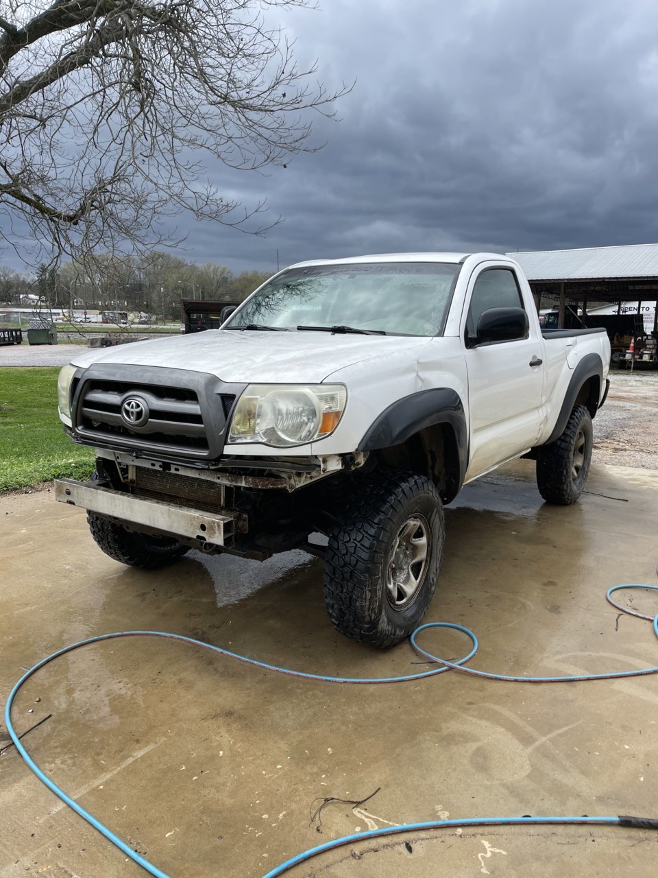

    Thanks bud started to txt you when we made it home but didn’t wanna bother, glad you checked in on it got a cool bumper and winch hopefully coming for it! Looking better by the day sprayed it off today.

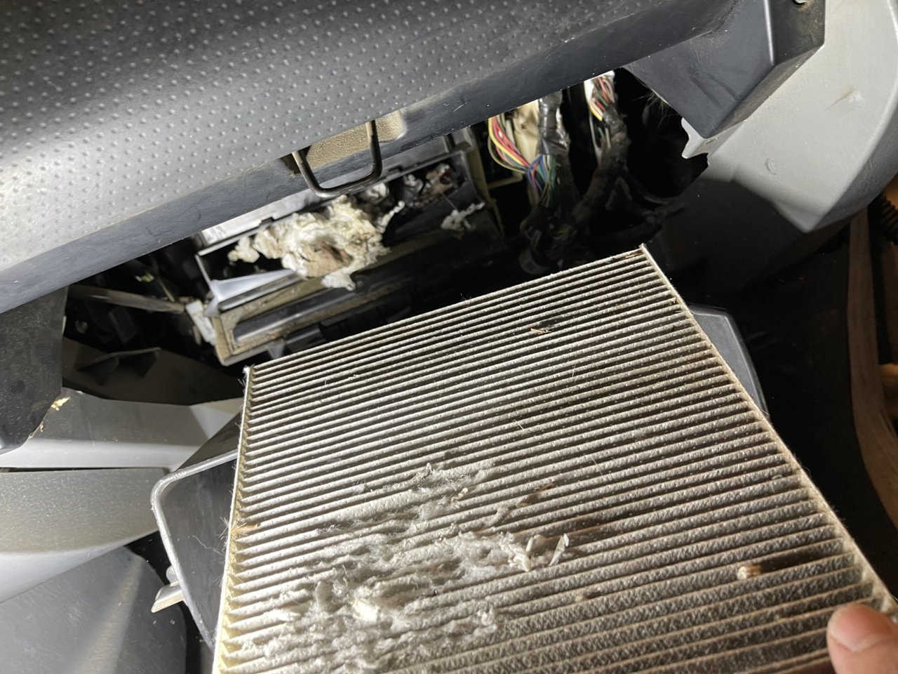

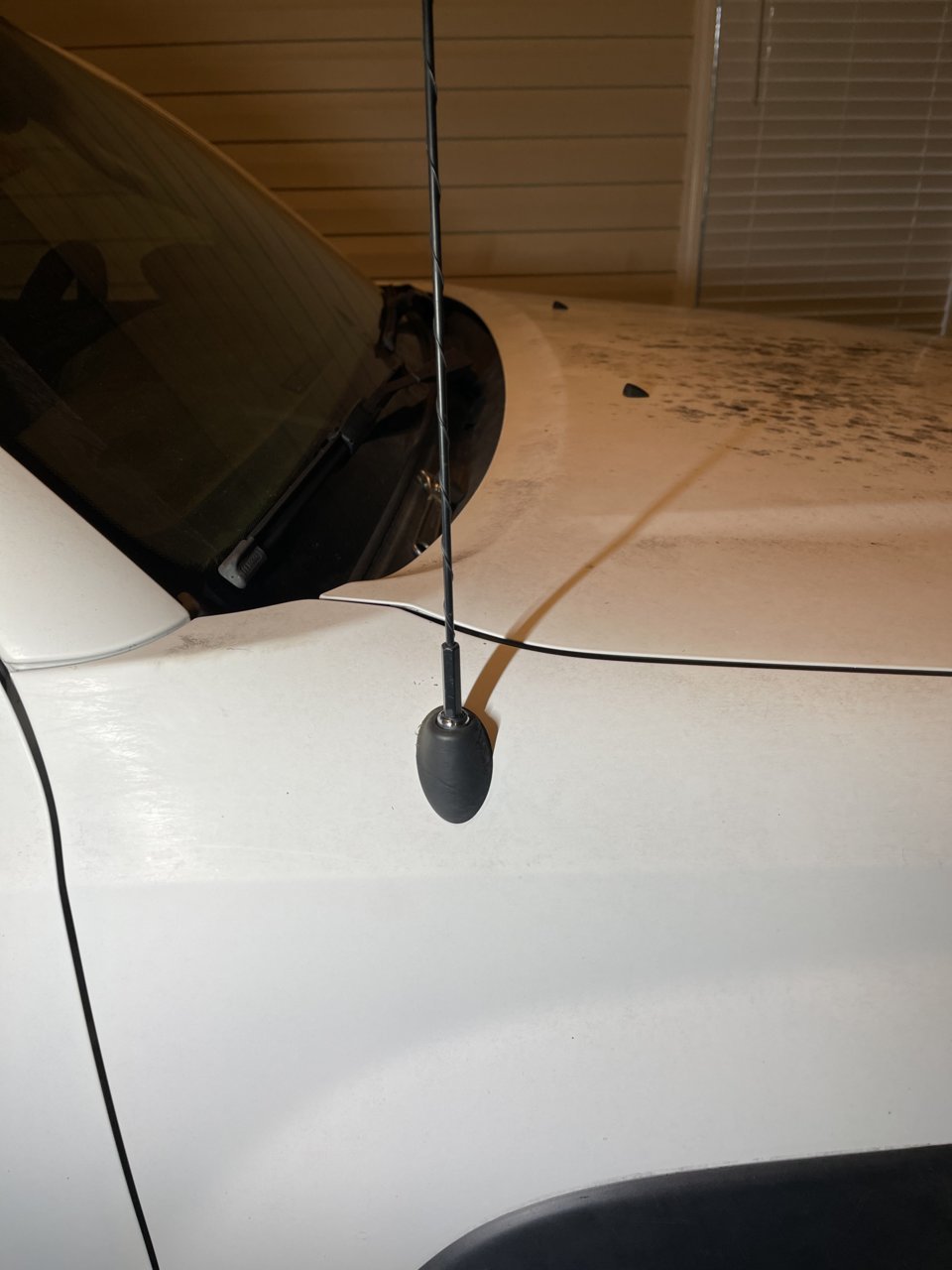

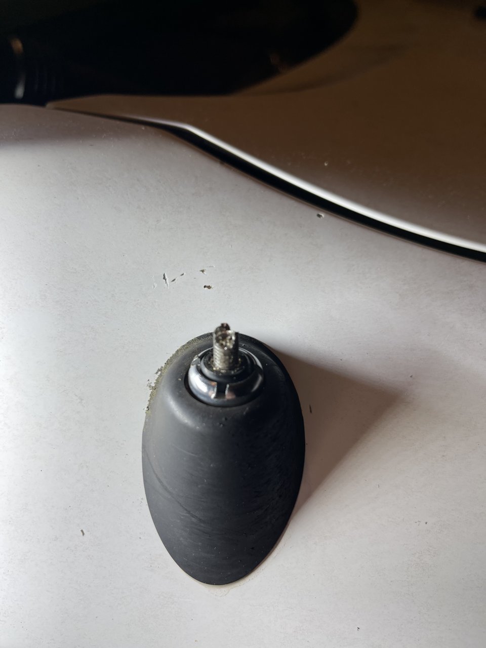

    Well that broken stub fought me awhile....
    But eventually ended up with this
    Then found there was a guest living in the cabin filter box cleaned that and now the air blows way better.

    Awesome. I had given up on the antenna mast, and yeah. There's definitely unwelcome guests when you park at the barn. I'm enjoying this thread! Keep it up!

    Lol I had too almost broke one left hand drill bit and thought I messed the threads up on the inside, but the second bit got it out and threads were okay. For sure lol barn mouse found a warm spot, keep checking in post some pics of the new truck when you get it!

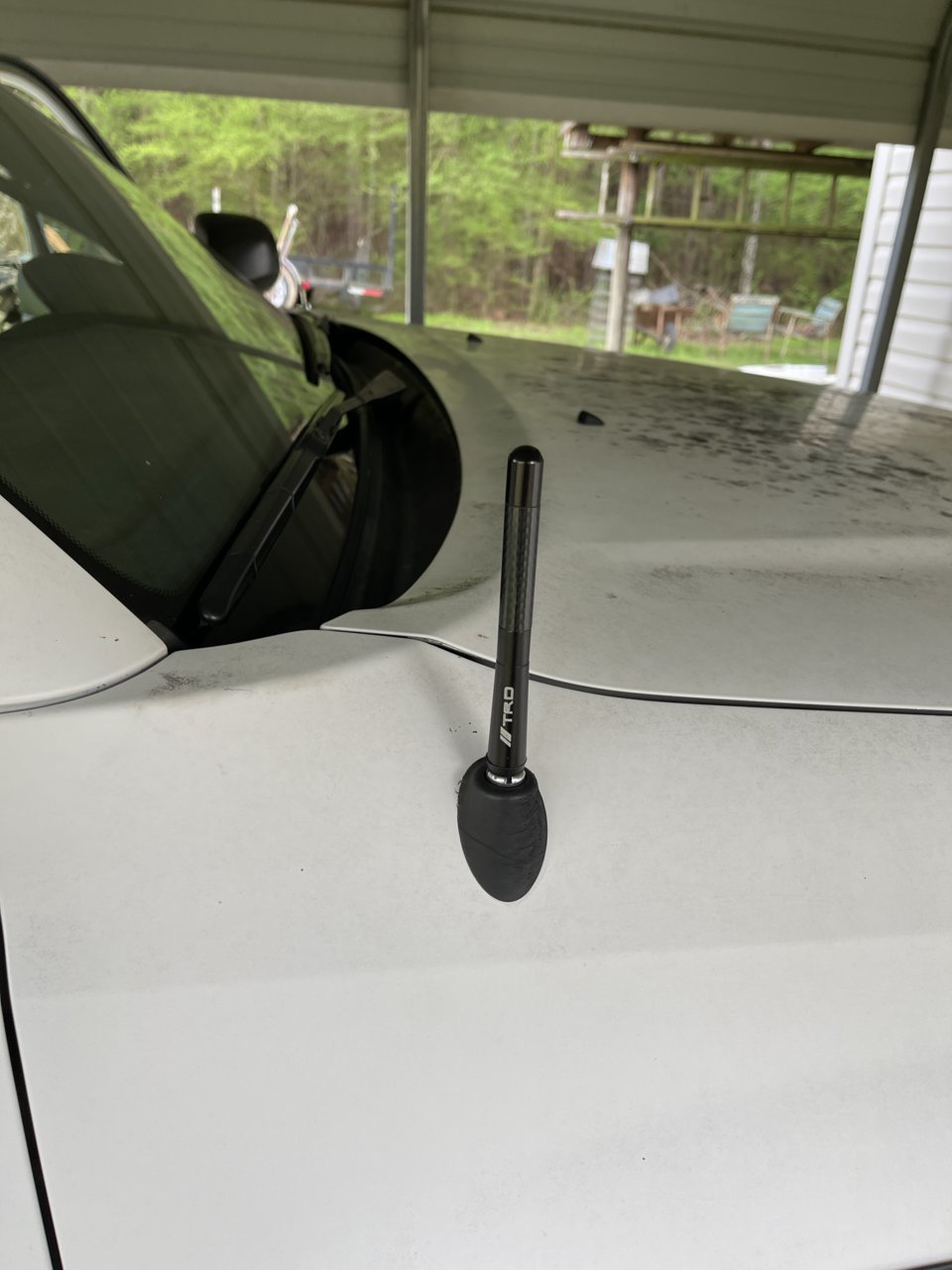

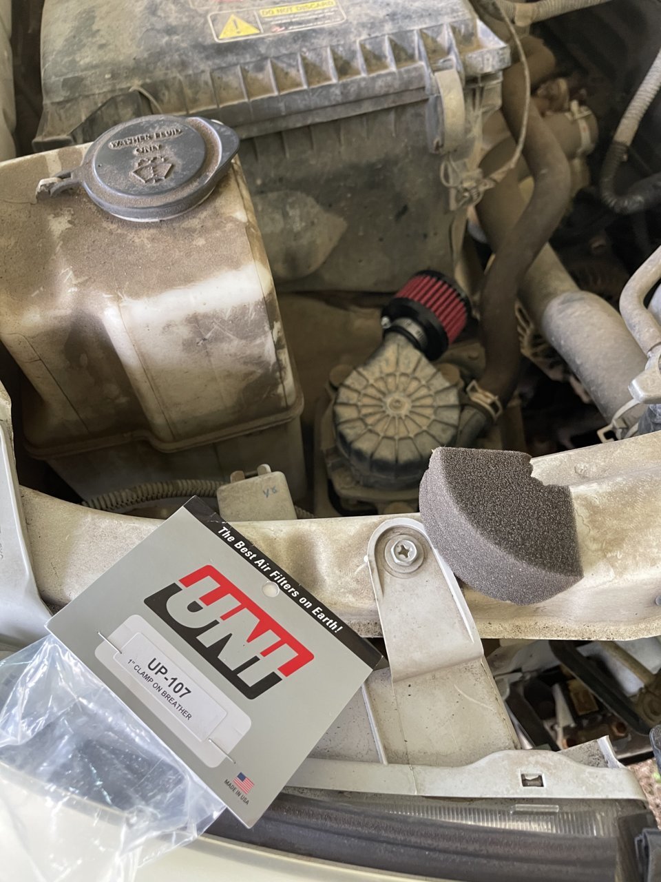

    Did the unifilter mod on the secondary air pump, even though the foam was fine preventative maintenance.
    And a cheapo stubby antenna off Amazon $10 and the reception is good I figure less likely to get snagged and break.
