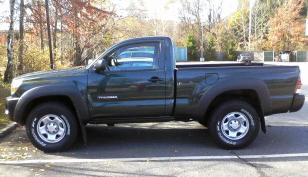

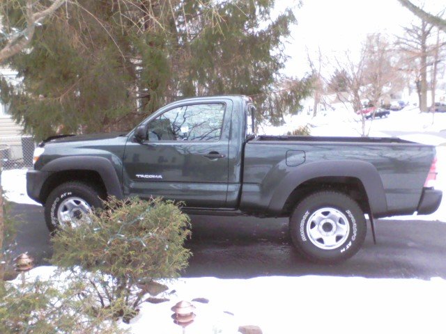

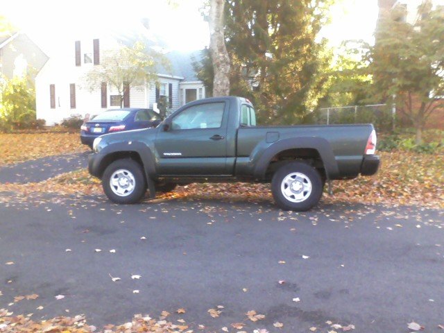

    Here are some pics as follows:
    1) Pic with standard suspension and factory Dunlops (245/75r16)
    2) Pic with standard suspension and Hankook Dynapro ATM's (265/75r16)
    3) Pic with leveled suspension (Bilstein 5100's at .85") with Hankooks
    From memory, the front end was about 1.5-1.75" lower than the front. Now I am pretty much level (will check dimensions later when I have access to a tape measure at home).

    Oops, forgot to mention that my driveway slants up a little so in the last pic, it looks like the truck is taller in the front.

    looks great!
    now for the black wheels and line fender flares right? lol

    Checked and I'm sitting about 3/8" higher on the rear based on measuring from the ground to bottom of fender flare. Measuring from bottom of rim (as some say you have to do), I'm 3/4" high in the rear. I guess probably could've gone a little higher on the Bilsteins but I'm happy with it.

    Nice, like the looks with the Hankook's on it. I have ~400 miles on the lift so far and love it. I think it should have come from the factory that way.

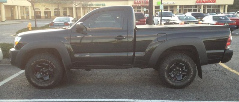

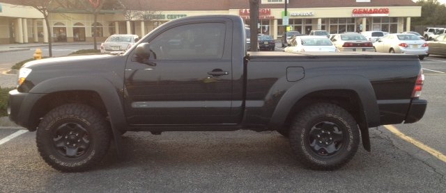

    i set mine to 1.75
    1st pic before
    2nd after, stock springs definatly level to me
    sig pic is how it sits now still at 1.75 on a hill though, tires are 265, 70 17

    Nice looking truck.
