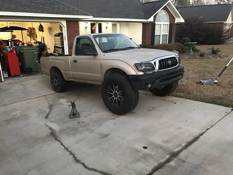

    i have 4.10s on my tacoma with 35's now on 6 inches of lift had to do minor modification to the fender well taking 2 inches out of it and welding a plate in and cut 3 inches off the valence but it looks pretty sick 2wd 5 lug

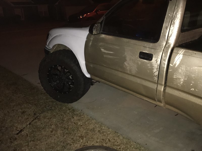

    Did you have to trim a lot?

    About 2 inches on front fenders at the bottom it's about 4-5 inches up the fender and 2 inches deep

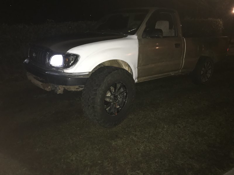

    IMG_0144.jpg 35's on front and back
