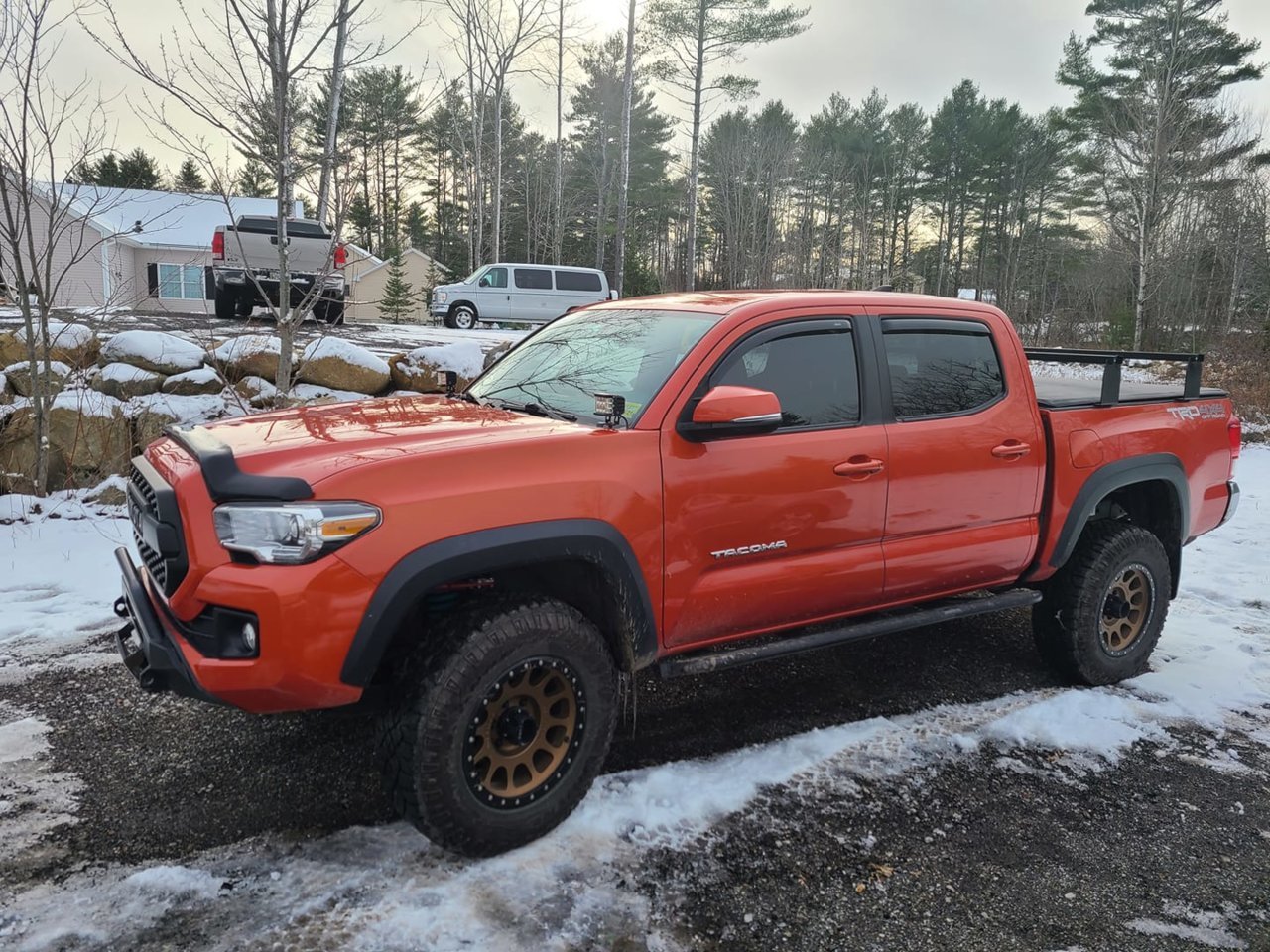

    so I have a 2016 TRD OR as pictured.. 265/70/17 duratracs on 17' rims, 2.4" Dobinson MRA lift with heavy rate coils, and 111R rear leafs with MRA shocks. Mobtown offroad sliders and CBI steel skids, with an SSO slimline hybrid bumper, and Smitty XRC 10k comp winch... so a bit of weight, adding on the new Max Modular 14" rack and RTT I am feeling every lb of weight, and feel the only solution is to re-gear to 5.29's in prep for getting 33" 285/70/17 or 295/70/17 tires...
