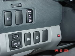

    Do you have a red LED/button on the left side of your dash?
    Like this...
    My 2007 has the VIP alarm and it had this, but it was attached to one of the blank switch covers (looks like this guy modified his). I have no idea if this is directly related to the VIP alarm or not, but I have to assume it is.

    I do not. I searched the forum here and I don't have any of the things like that, nor the one that goes in one of the blank switch spots.
