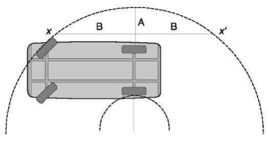

    The problems arise when cornering in a 4WD vehicle because each wheel will take a different path around the corner and thus have a different amount of rotation. This is where the differentials in the front and rear come in but like you said, each differential is powered by its own drive shaft. If the drive shafts from the front and rear ever turn at a different rate then it causes binding within the transfer case and can potentially cause damage.
    Because the differential is a mechanical device it can be said that for a given rotation of the driveshaft there will be a set amount of tire rotation on that axle (whether all in one or divided among the two wheels attached to that axle). Because of this, if the distance traveled by the front axle is ever different than the rear axle, there will be different rotational speeds of the drive shafts and binding within the transfer case.
    As for your question on whether "open" differentials were best for exercising 4wd components I would say yes but this is purely my opinion. Open differentials are best suited for normal driving and most people don't really lock their differentials unless they know they are getting into a sticky situation. As you stated in the beginning, as long as you use it every once in a while you should be fine.
